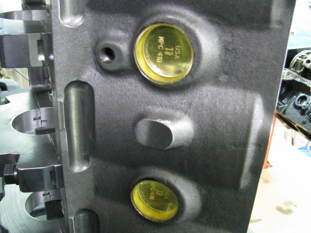

heres a pick of the 2 blank bosses,
Attached Thumbnails What thread is a knock sensor?-dart-deck-ra-test-3-12-048.jpg   What thread is a knock sensor?-dart-deck-ra-test-3-12-072.jpg   What thread is a knock sensor?-dart-deck-ra-test-3-12-078.jpg

Originally Posted by Strip Poker 388
would the aluminum change the frequency of the detination to the knock sensor?
It doesn't change the frequency of the sensor, but it will effect it's sensitivity. The GM knock sensor that Merc commonly uses has a frequency of 10.5kHz. Different block locations can change it's sensitivity, putting them in brass y-blocks, etc. If your EFI system isn't capable of fine tuning the sensitivity then sometimes you have to move them around or use adapters to avoid detecting false knock. The block will drill and tap pretty easy, I'd put it there if you don't want to use the drain hole.
