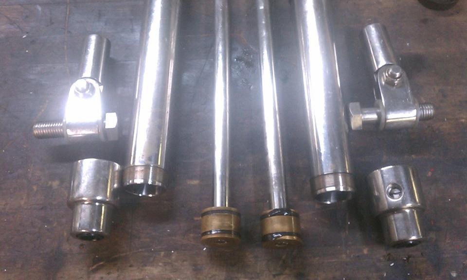

It's nice to take something apart and actually finding the problem right away. Boat would drift to the Starboard side and would need to be corrected every so often.

A trip to the local hydraulic shop.
Attached Thumbnails Steering Rams Rebuild-seals.jpg   Steering Rams Rebuild-ram-part-.jpg

I understand what your saying but the custom stainless barrels, clevises, shafts and mounts is probably where the expense comes from. To make new stainless rods the my hydraulic shop quoted $400. The threaded part is a little bent on my rams.

Rookie- How did you get the ends off without marring them?
endeavour32 is offline
Old 01-27-2019 | 09:42 PM
Rookie's Avatar
Joined: Jan 2003
Posts: 6,025
Likes: 1,522
From: Grand Rapids, MI
Pipe wrench with a sheet of urethane rubber over the teeth. I also had urethane over the jaws of the vise holding the thick end,
