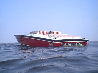

ForrestC,
I think the boat that Kamma is speaking of is Greg's from Gorilla Powder coating in Crestwood, IL. I'll try to run by his shop and get his phone number for you. His boat was featured on The Lovely Lady's of Motor Sports a few years ago. The whole boat was restored. Here is a pic I took of it a few weeks ago.
Dan
