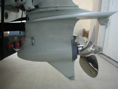

Well, I hope the nose cone helps your slip. Those lower units are pretty blunt, and may be causing your problem. The pic below is what mine looks like with the cone installed.

Kent / Havasu, UPS just delivered my two Hydromotive Volvo nose cones, and Havasu, it sure looks like it going to take a little doing to get 'em installed properly and faired in. Did you guys need to clean up the inside of the nose cone to get a tight fit? The reason I ask, is beacuse when I hold it in place it against the lower unit, there seems to be a few gaps here and there. Also, what kind of filler did you guys use to fair it in?

...and Havasu, it sure looks like it going to take a little doing to get 'em installed properly and faired in. Did you guys need to clean up the inside of the nose cone to get a tight fit? The reason I ask, is beacuse when I hold it in place it against the lower unit, there seems to be a few gaps here and there. Also, what kind of filler did you guys use to fair it in?
Forrest- When I spoke with the guys at Hydromotive, they made it seem like it would be a piece of cake- far from it.
I saw the same thing you saw- the cone does not seem to fit very well. I had BIG reservations when installing, because it seemed like it was not made for my bullet, and you have to get it perfectly straight. I even had to start over one time.
I took the drive down to the metal, and even did some grinding on both the cone and the bullet to get a snug fit. For lining it up, I had the drive upside down, and eyed it off the skag. Also, I eyed it from above using the centerline of the top plate in relation to the shaft.
It still didn't look snug, but that's what Hydromotive told me to do. I then used the Sea Goin' Poxy Putty that came with the cone to tack it on. More grinding and sanding...also be careful to keep the putty off the drain plug on the bottom.
Before backfilling, I also took some material off the sides of the cone, to streamline it a little, and make it easir to fill.
I used some 4x4 Bondo for backfill. What a pain- I was not as good as I thought at body work. Took me 4 tries to get it right. I've heard there are better fillers out there- after 2 seasons, I have a couple hairline cracks in the filler at the bottom. I have been told that this is from flexing- if I had welded it on, then I may not have the small cracks.
