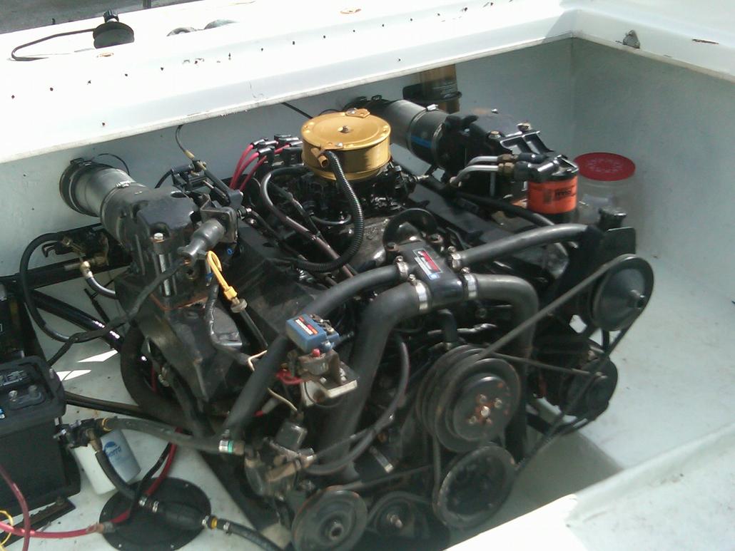

Here is a pic off some ss piping I used instead of exhaust hose and got reversion first time out,Im not using them again.[ATTACH=CONFIG]514310[/ATTACH]

ss or rubber does not make a difference IMO. flappers, and maybe even on the outside , might help, slowing down slowly not to take the hit from the wave behind... couple different things can help!

those pipes in the picture are level then drop down with no internal flappers then came off plane to fast and steam cleaned some exhaust ports

I backed a non-thru hull into launch too quick and caused it also!! On thru hull: If no internal flappers, get external and i always give her a little throttle when she is about to sit in water coming off plane.
You wont have to worry about reversion too long if you keep that squeeze bulb for your fuel in the engine compartment.

Thats funny,I just put the engine in the boat and used the bulb to fill carb,no longer in boat,I like people that pay attention to detail, good eye
