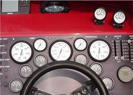

US-1 my Fountain was set up exactly as yours with the SW guages and I had the same problem you are having. I replaced the tachs and the problem dissapeared. I put Faria tachs in and am in the process of replacing the rest of them. I'll probably catch flack for using the faris but I have used them before and they work excellent plus I really like the look of the Euro white style.
