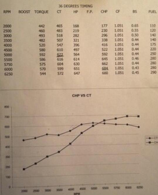

Please explain the 684 HP / hair dryer ??
What do you mean? I just posted N/A...
Jim Valako Dart Race heads matched with intake...he is no joke. There are many here on oso to verify. Not sure why you are even going here.

Just went thru this today on my 555 NA motors. -8 or 1/2 from the tank to pump, -6 the rest of the way. 8 lbs fuel pressure at idle per electric guage on fuel dist. line. Your pressure seems low from what I have seen in the past.
As far as your HP goes, 684 NA isnt that crazy to achieve IMO. I get the 509cid limiting factor however I m sure the heads and intake make up a bunch. What carb and compression are you at?
Im not knocking on the motor or the builder, those are great numbers for a single carb and no help.
