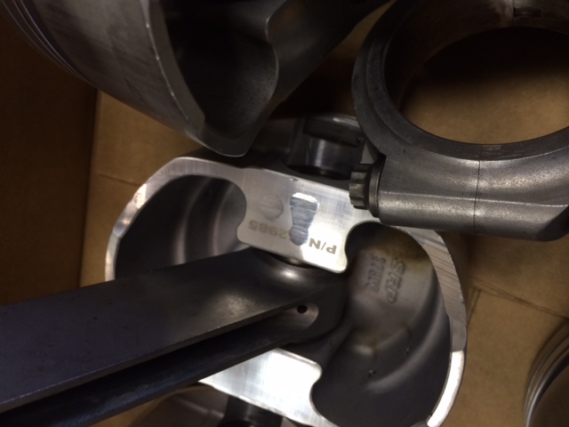

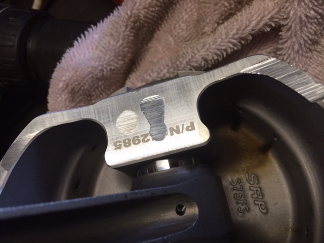

Amazes me... I am not re-using any of it in my new builds, all new even blocks...cranks were even hitting bottom of pistons!!! how do you not feel or see that when ASSEMBLING?
But I didnt twist a rod!!! LOL

Holy fack , looks like Randy's janitor's stepkid built that engine . Turned over nice and free by hand after assembly I bet .
