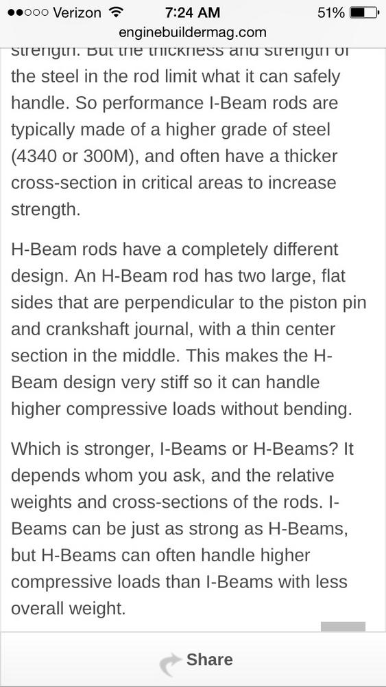

I always thought H beam was stronger in some cases, this is from engine builder magazine..[ATTACH=CONFIG]534018[/ATTACH]
