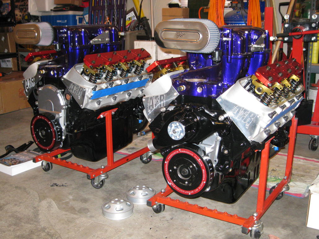

Originally Posted by horsepower1
I wouldn't even consider an off-shore type build without a stud girdle.
Me ether

Originally Posted by 33outlawsst
Me ether
they look like webster industry,s.did you get them from bob?
Me ether
Nice looking engines and no offense, but I would not run a Professional Products Damper on an off shore engine (or any other engine for that matter).
Yes, their nice pieces
Nice looking engines and no offense, but you need to throw those harmonic dampers in the ocean...
No salt water close to me............so I guess I'll keep em
