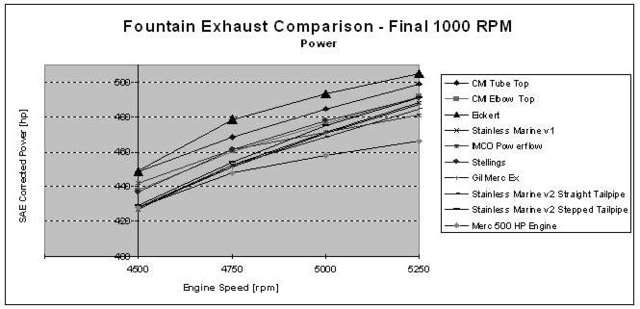

Fountain Powerboats did a comparison on exhaust systems some years ago. [ATTACH=CONFIG]549261[/ATTACH]

PF Marine was first who design and made the aluminum manifolds then worked a deal with KE that really never took off as planned, years after sat idle until Diamond currently is offering the past X amount of years.
With that said I just talked to the guy in person that helped with all the dyno testing from day one with the original PF Marine designs. They were equaled with the numbers on the dyno to best marine true header on the market at that time frame.
