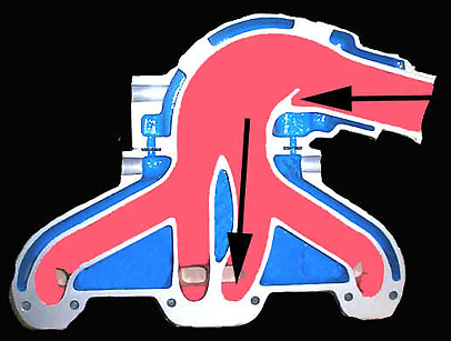

Here's one in a basic exhaust manifold:
SB is online now

Gotcha. Thanks. That looks like something that would have to be put in the collector since it actually sticks out farther than where the water is introduced.

Yes, in collector, but no, it is before the water enters the exhaust stream. This way, when water is sucked back, it hits this instead.
Cup your hand halfway, tilt at a 45* angle, and you'll see what it will basically look like put into a header collector.
