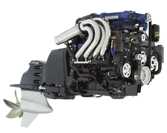

Originally Posted by bavboym3
I also haven't seen this fuel pump cooler.
does you setup look anything like this ?....the fuel cooler and the pump is right below the crank pulley
