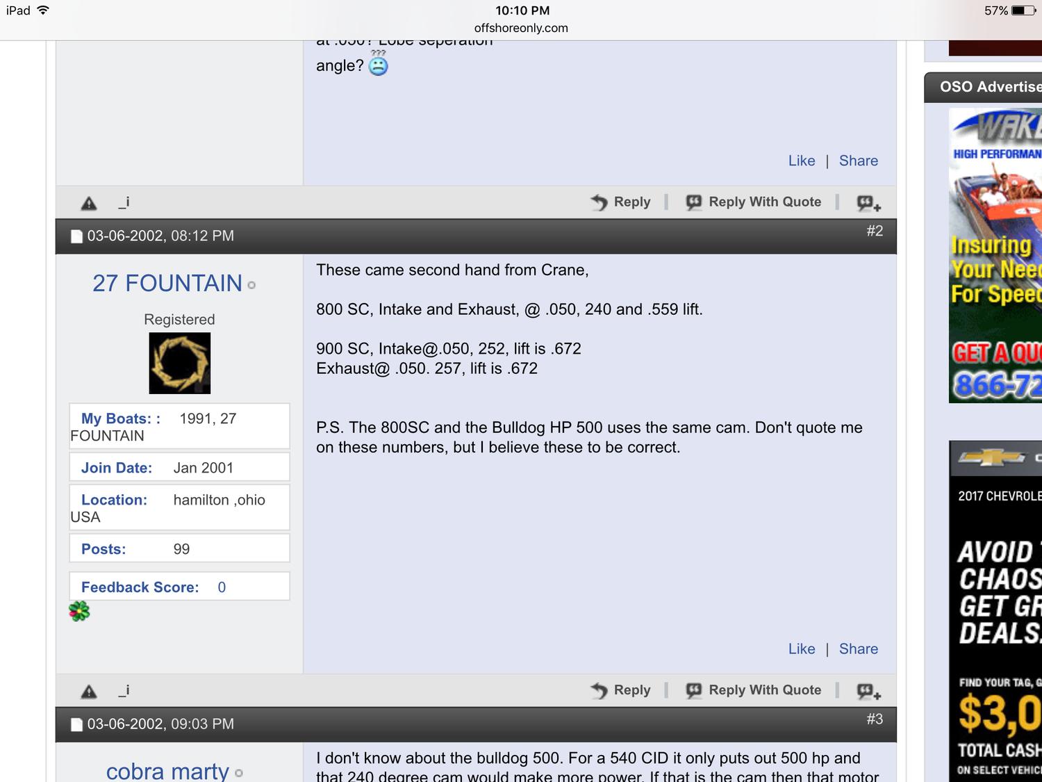

I confused myself. What can I say. Anyway when I originally tried to help OP out this is where I got the info from however you very well may be right. They are however the same sutphen30 sent me recently for the 1075 cam specs. Lift and dur anyway. I did just read a thread that 900 sc was something around 714 lift SR also but again I read it I and can't actually confirm it. So let the mystery continue. Lol

Hey Mike I believe it is a solid roller 252/257 672/672 on a 112 with an Iron gear .030 hot lash, but if you can call to find out that will clear this up quickly for the OP
