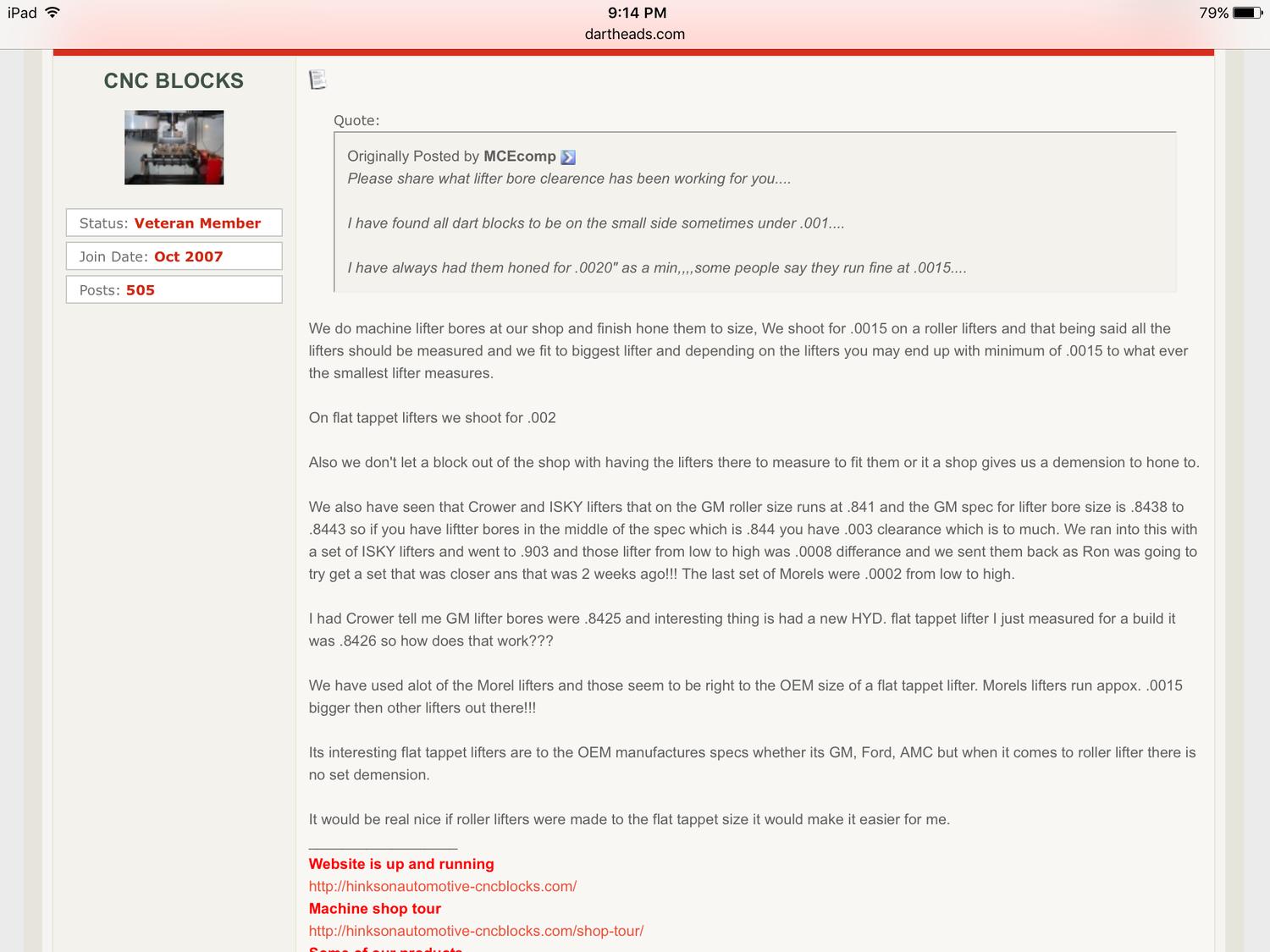

I machine alot of lifter bores for lifter up grades to .904 and .937 rather then go to an .842 with bushing I would go to a .904 or .937.
I have seen about every lifter out there to size for lifter bores and to date ISKY .842 lifter are not .842 more like .8405 to .841 to put them in a .844 lifter bore and end up with .003 to .0035 oil clearance in not going make for a happy lifter. Same with Crower. There seems to be a lot of sizing issues that have never been addressed. The last set of bushed lifters had sizing issues and the Customer was not happy with their 1400.00 lifters.
Don't get me wrong ISKY makes a good lifter but having to buy 2 if not 3 sets to make up one set is not very cost effective.
Do a search on Yellow Bullet forum there is a lot threads about lifter sizing.
Comp Cams, ISKY and Crower and Jesel .841 lifters I have had to bush the lifter bores back and fit them to .0014 to .0019
Roller lifters like a controlled environment have oil clearance .003 to .0035 is not good.
Having alot of oil clearance with cost good HP because of extra unwanted bleed off.
Oil control is key to making HP

There Does not seem to a standard when it comes to lifter sizing compared to OEM sizes
