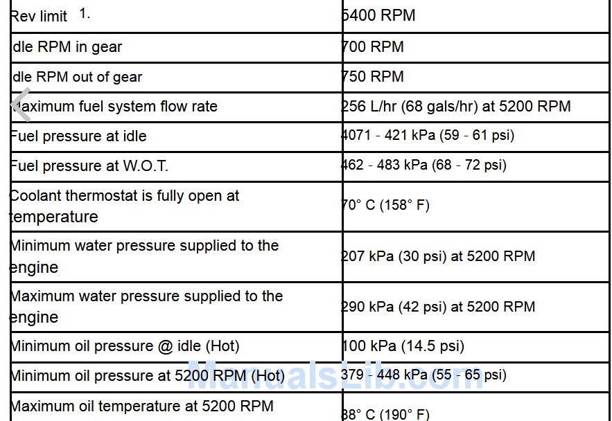

Id like to think, that Mercury Racing, has done a little bit of homework on their high dollar engine packages. What their reason is for limiting oil temperature, I dont really know. Whether its life of the oil, cooling of internal engine parts, or what. But for a guy like me, who doesnt have a multi million dollar R&D department, I take some of their recommendations seriously. Definitely would take what they do, over what I read on the interwebs.

Oil temps in the pan are the average of the oil temps seen in the motor.
A long time ago, a test was set up with a SBC to measure oil temp at the bearings and various other places. They found that bearing oil temps where 60*F - *75F hotter than the oil temp in the pan.
So, this is why some prefer to measure oil temp in the pan, again because there is a reference to go by using this method.
Bearing material and oils used at the time (I believe before synthetic oil was widely used) where considered and a general guideline of target oil in the pan temps was created + generally agreed upon.
The following charts (engine + trans) are pretty much based off of that.
