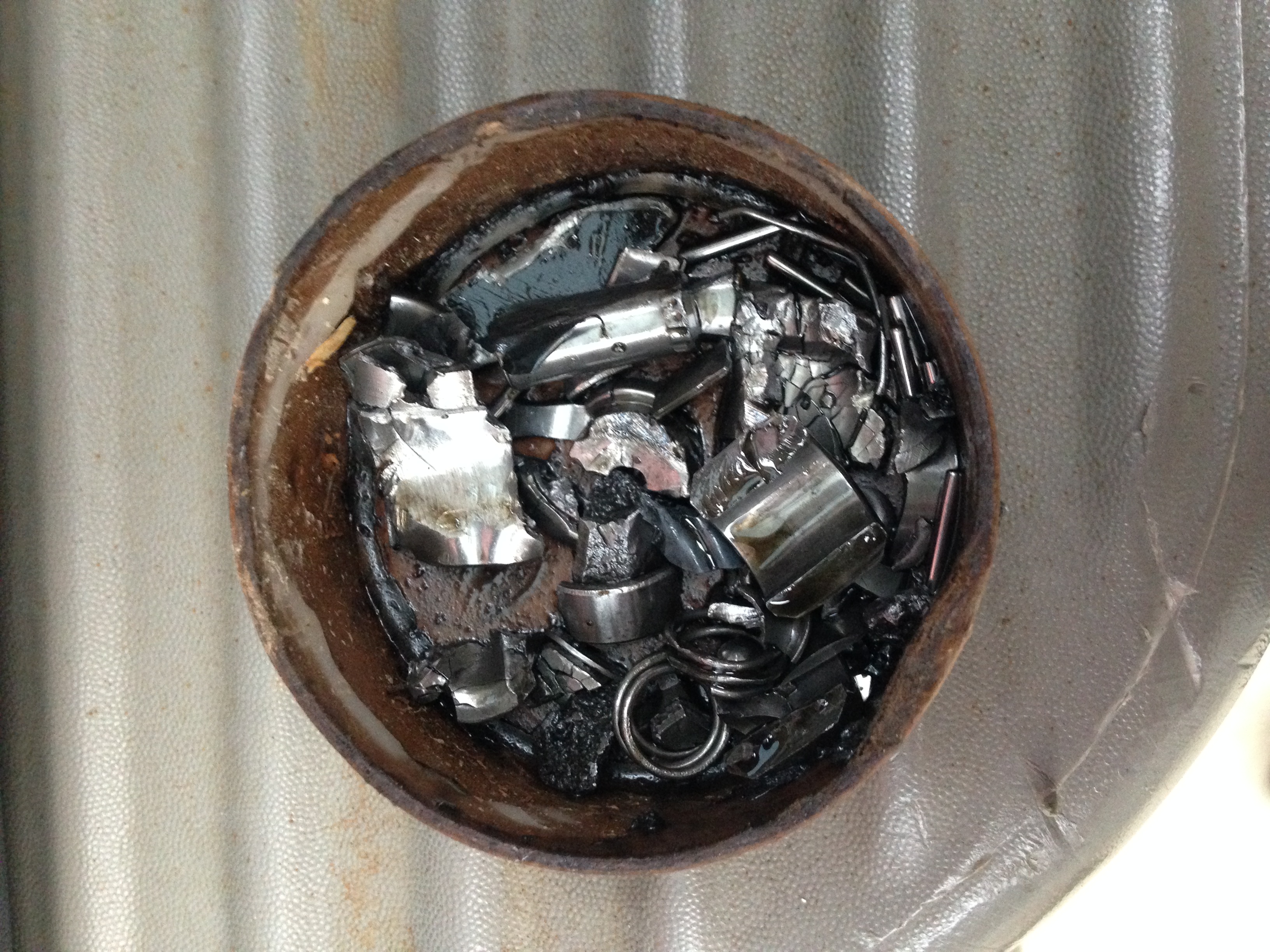

I think the problem has been found. Been chasing noisy lifters for over a year. Maybe didn't use special XFZY 0w37.5969 weight...

I agree, If you did use special XFZY 0w37.5969 weight oil you would be all set.
Some pieces/fragments missing...that suks.

That beats finding a lifter like this

Lame...What brand lifter is that?

Originally Posted by Diamond Dave
Lame...
Huh?
I'll have to check brand. I believe it's short travel high RPM lifter. Put some solids in and lashed to 0.007" problem solved. And they're quiet.

definitely not a morel , looks more like a johnson lifter body. Morels have a .750 wheel, and fork style body, like most solid roller lifters

Looks like a Johnson to me as well.

What about a Topline High Lift Johnson ?
