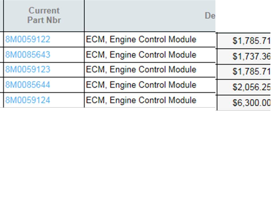

Was looking into the 8.2 Base and HO differences and used BAM's part number look up. The only differences I could find was the PCM. They use the same, cam, crank, heads valves, injectors, fuel pump and regulator. Can anyone verify this?

I noticed the restrictor plate yesterday, but could not find it on the parts list break down. After looking again this morning, found the flame arrestor adapter (8M0045765 and 8M0045766). There are two different ones which I'm going to assume this is the restrictor plate as mentioned in the other thread. So anyone could change their Base to an HO model by changing out the PCM and the plate. Only issue to still need figuring out is which is the part number for the HO? I'm guessing its the higher cost one
