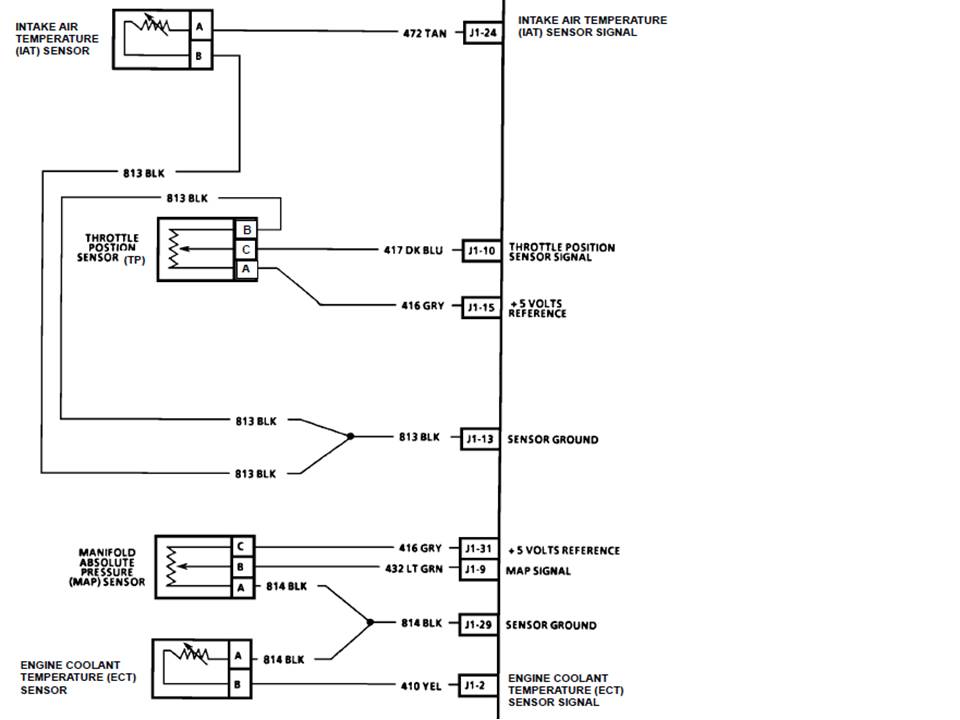

I used CRC 656 and a toothbrush to clean the small harness side connectors. The ECM harness was pristine.
Today I tested the ECT for 5v, it's good. I replaced the ECT for good measure as well. For $17 it's not worth testing the temp. range on a stove top.
I tested the TPS harness side per the manual as well and when I got to "hook a test light to battery + and then touch the light to blue wire on the harness side connector, does it light?" it did not light and flow chart says replace TPS. Again for $39 w/lifetime warranty I'm in the middle of replacing it as well.
During the key on procedures above I can hear the IAC whirring away for a couple of seconds. At least it sounds like it's still in on piece. IAT harness tests good as well and I cleaned the sensor with MAF cleaner.
After 10 hrs. Installing new trim tab hoses and locator system and doing the above didn't have time to start the engine to see what if any change I made.
After setting the new TPS to 0.7V at idle last night the engine idles (cold) on the hose at the correct rpm and without any issue. The real test will be after being out on the water then flushing to see if it will stay running or not. Hopefully this weekend if the weather holds up.
Keith

Fail on idle again at the ramp. Fired it up and it was pouring out black smoke and idling at 1100 rpm. This is after running perfectly on the hose last week, no changes were made. I checked the new tps and it was at 0.7v as tested above. Swapped MAP sensors and it was no better. Code reader got "TPS high" and "coolant temp. Low" and would not clear them. I tried adjusting the TPS value down and it wouldn't net below 0.6v at idle, put the old TPS back in and set to 0.58v (lowest it would adjust) which netted clean burning exhaust and 600 rpm idle. Codes still read "tps high" and "coolant temp low" Took the boat out and around 1k rpm it still surges (TPS value stays steady) . Put it back on the hose to flush out (at the ramp) and idle was steady at 600 rpm.
Short of trying another IAC (current has less than 20 hrs on it) or swapping ECU's I'm out if ideas.
As stated by others above the scan is desperately needed while on the water and the issues are present to see what is happening with all sensors etc. at the same time. I guess I'm not going to solve this on on my own.
