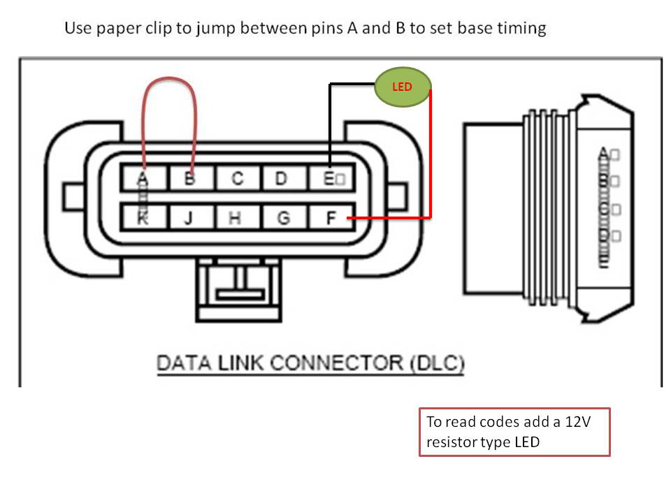

You can scan for codes with a paper clip and a resistor 12V LED (radio shack), but sounds like your new IAC has gone bad.
Attached Thumbnails Help Chasing Erratic Idle Please-dlc-led-code-reader.jpg
As described in post #1 I scanned with a Rinda codemate and didn't receive an IAC code. The codes I did receive are posted in the OP.
