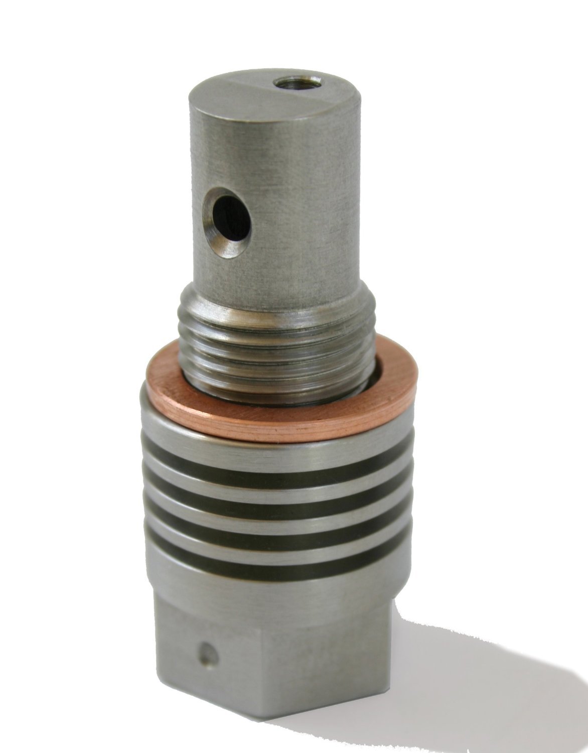

Innovate Motorsports 3729 Heat-Sink Bung Extender HBX-1
by Innovate Motorsports
Link: http://a.co/dtaAnSI

Sb is correct it raises it up and protects it. The hole has an indexing mark on it so you locate the hole pointing forward and the exit is on the bottom. Some people have argued that it changes the reading. I have done back to back dyno pulls and only very slightly slows the reading down. The ntk sensor is a far superior sensor but find myself still using the Bosch and just replacing them alittle more often just to be on the safe side. Like stated earlier the sensor at the 12 o'clock position is critical. No matter how mild the cam is the sensor won't live if it's down towards the bottom of the pipe.

Yea have done that before on the anti fouler lol. If you call innovative they will tell you the magic is in the hole placement, size, chamfer etc. When I say slow down it really acts like the smoothing factor on a dyno. Makes the sensor act less erratic. You would see more delay in the sensor/afr response moving it from the primary to
the collector in a car type header.

I use the Innovate heat sink SB posted. I will echo virtually every comment that Indysupra has stated regarding using this product. AFRs are unchanged (I too did back to back).
For a marine application this is basically used to prevent water from coming in contact with the O2 sensor. Heat is not the issue.

I too use the Innovative extender. Can't remember the last time I replaced an O2 sensor. Same for me with back-to-back testing. It's a nice design - the chamfer creates a low pressure point at the bottom hole and helps draw the exhaust gasses through the front hole and into the chamber where the O2 resides.

When I pull the bung out of my pipe it shoots water everywhere enough for me to ask the question here, and it turns out that any air leak will cause reversion. I have the heatsink extender and when I pull it out it's covered in dry soot with zero moisture. That was a real good demonstration on how a motor could hydrolock because of a bad header gasket.
