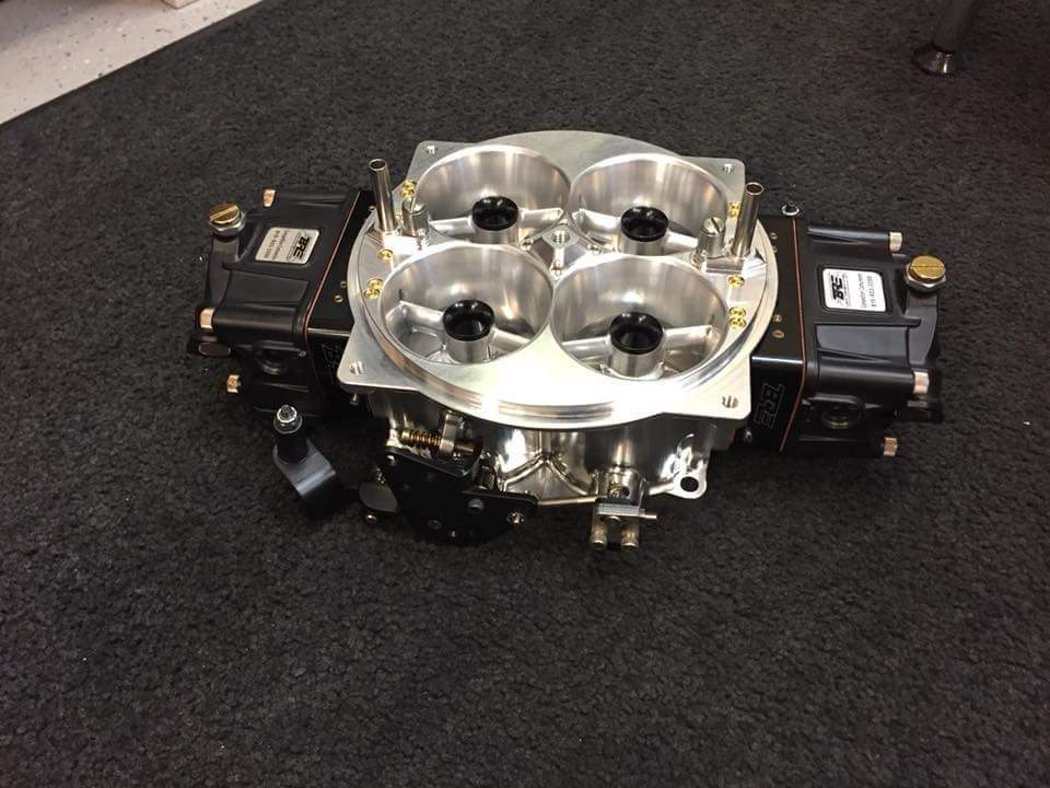

Default Carbs
These here should do just fine.
I cant see but you might want to get the bodies anodized.

Default Carbs
If we ran in a lot of heavy salt water I would but we don't. Our other ones stayed nice but we were all ways clean on the engines witch we are fin with.

I like the 4 hold down ears on the main bodies .

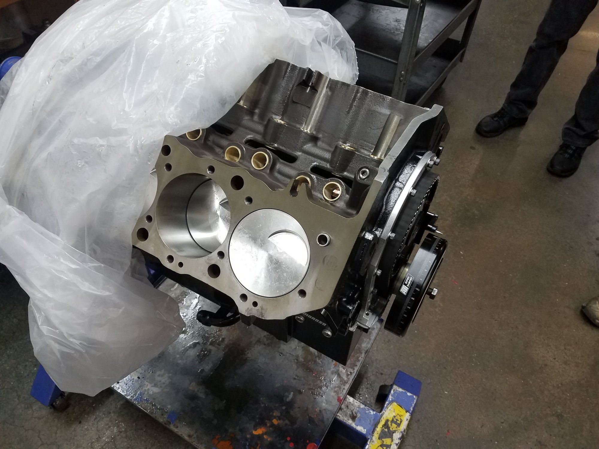

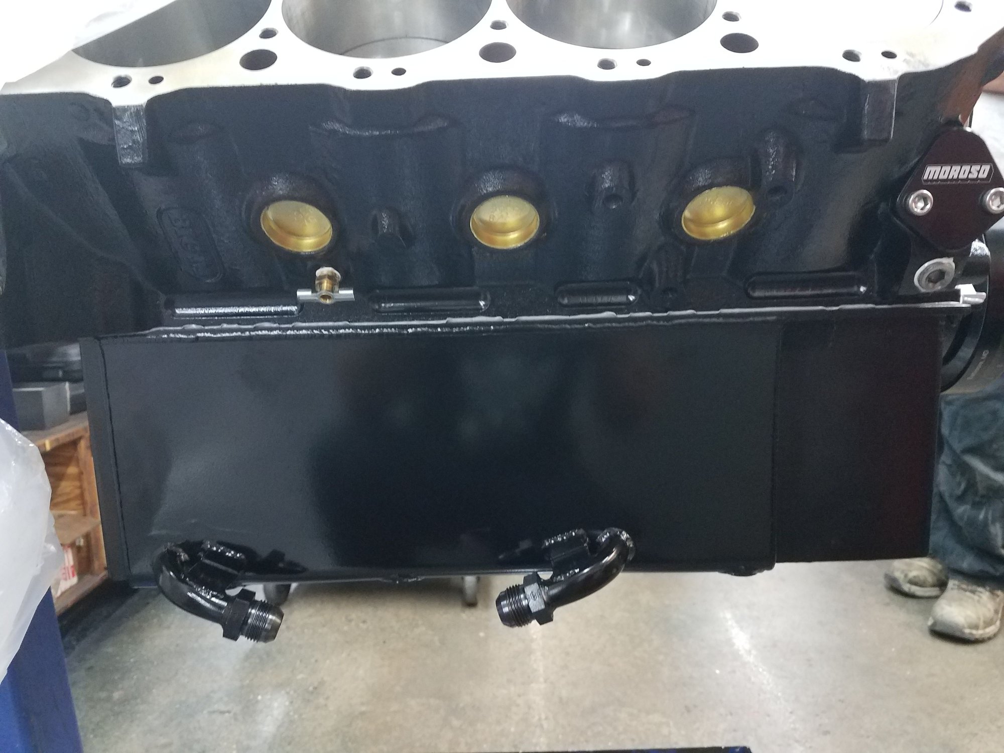

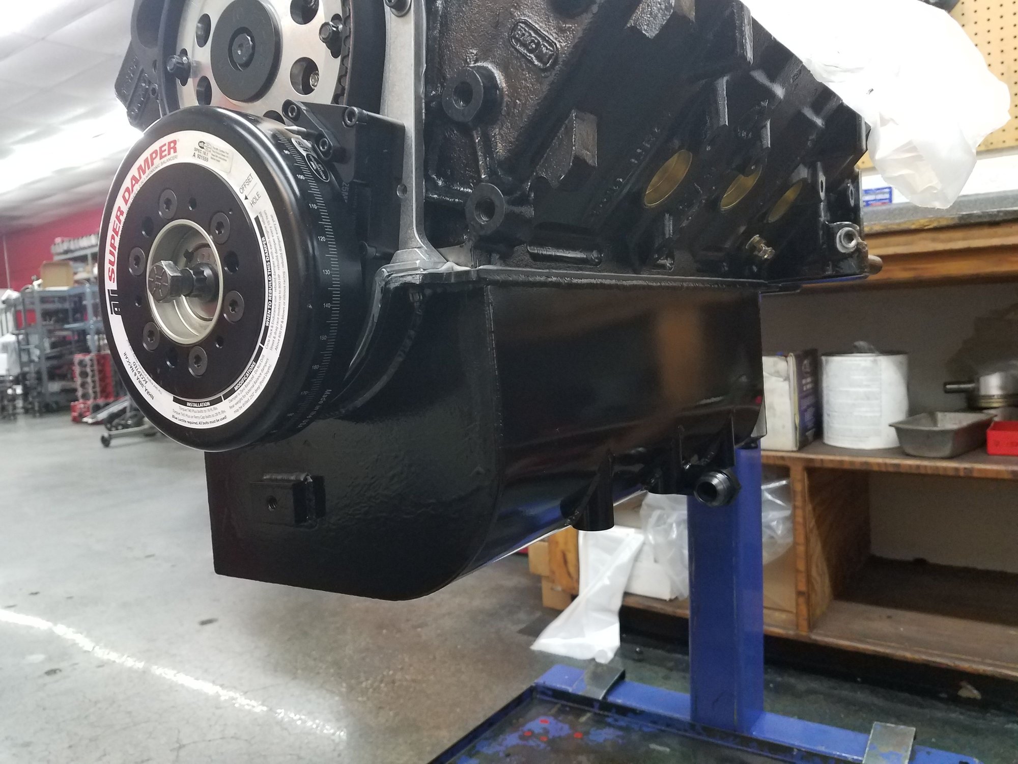

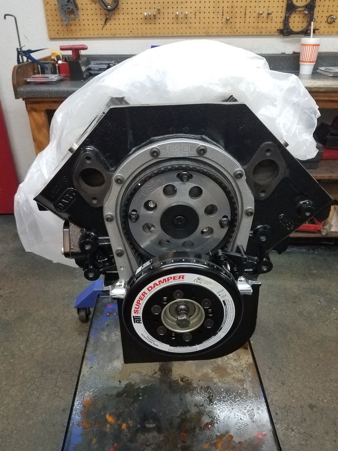

Old 04-18-2018 | 04:53 PM
  #180
Joined: Jul 2017
Posts: 190
Default Engine
A few update pictures. Both our shops David's and ours have been very busy but here is a few update pictures both short block are together.
