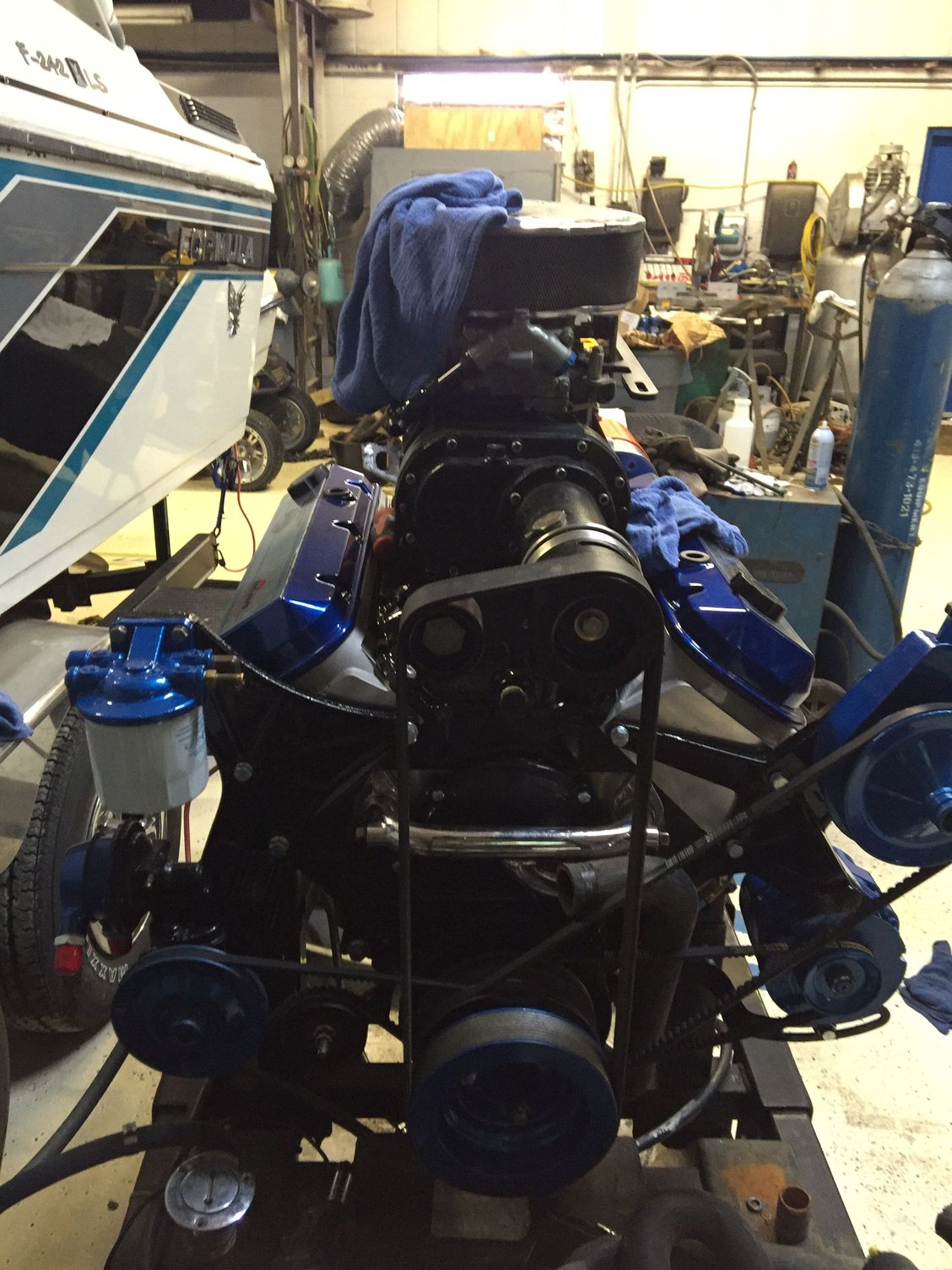

Here's how mine looks now......I went with a 3" taller exhaust last year since I hated how low the original exhaust was. You can see I still have height to move everything up a few more inches with the +3" risers
