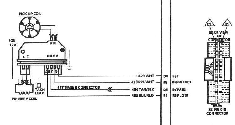

I dont know enough about the DUI ignition system to advise you or comment. The TBI V8 distributors have a 8 tooth timing wheel
picture shows a 6 window trigger but here is what is what it should be
https://cimg7.ibsrv.net/gimg/www.off...bfb8969437.jpg
https://cimg7.ibsrv.net/gimg/www.off...0c7004a869.gif
