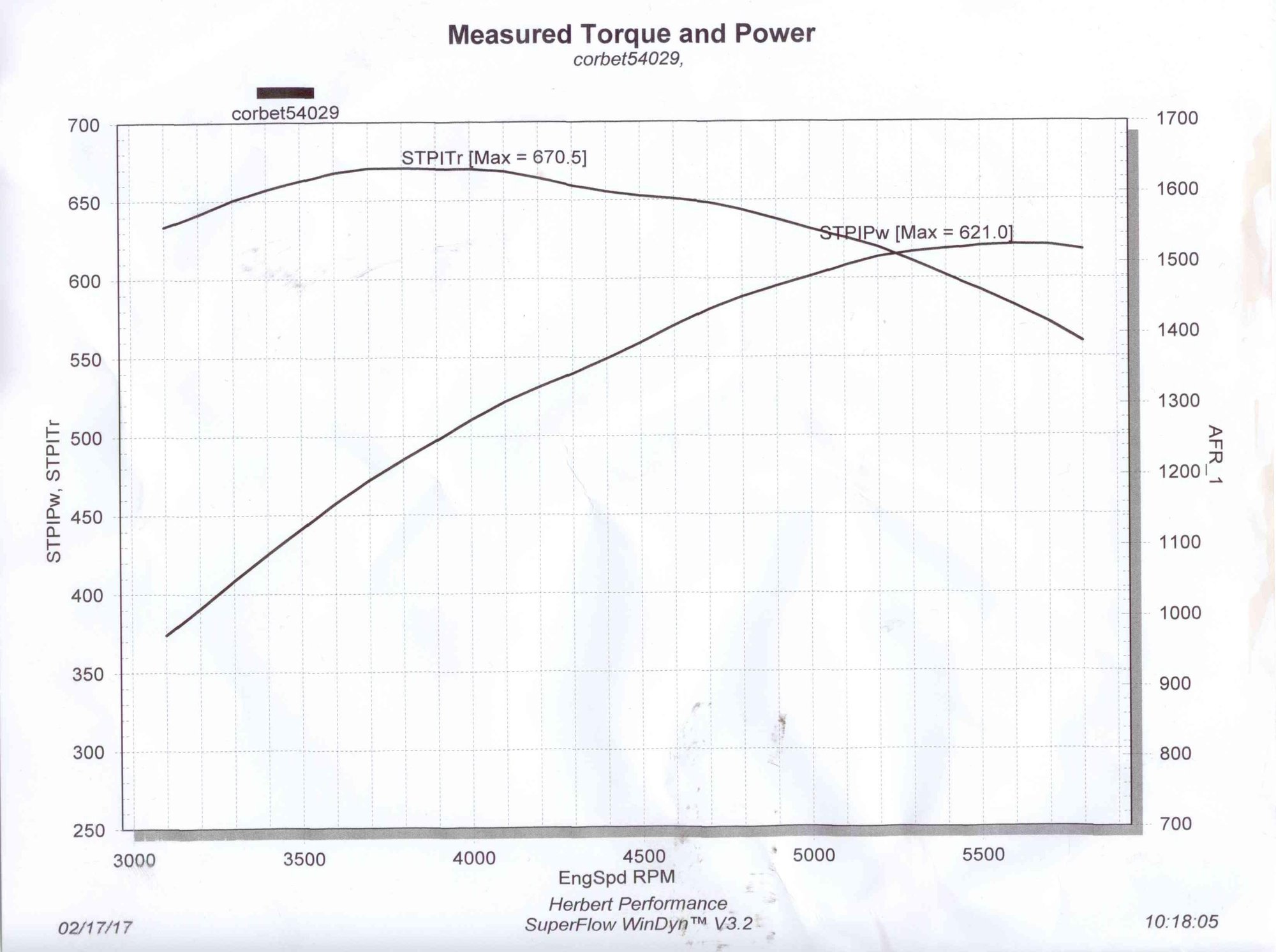

Not very happy with the performance of this reground cam so I am looking for something to push my single 30 ft Advantage better than what I have. I currently have a Crane 741 in my Summit Racing cart to buy but before I pull the trigger I wanted to see if someone had something better to suggest. I have read a ton of threads on here on cams and the 741 is very popular it seems. My motor is a 555 with just over 10:1 compression and has some massaged 088 heads with a single plane intake. My main concern is reversion as I have Imco Thumper exhaust. Would love to have headers but just not in the cards for right now. I also have a step nose Gen VI cam.

I did install it @6* advanced when it was a 548 and got some very minimal signs of reversion. Since I rebuilt it this winter I installed it only 2 degrees advanced and am seeing reversion plus not very happy with the performance even though it dyno'd well as a 548 at 6* advance.

Well, we did mention turbo. What’s the current cam specs? Edit: Nevermind. The cam card pic finally loaded.
