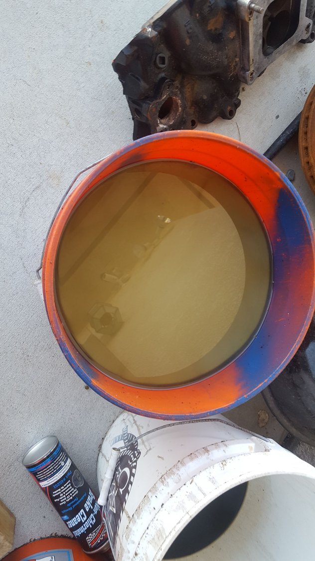

imo,that is not condenstion,that is water in the oil.
MILD THUNDER 07-03-2018 01:15 PM
I agree with Mike Tkach ^^
payuppsucker 07-03-2018 01:21 PM
But it looks awfully clear in the bucket and on his hand...............
Ryan00TJ 07-03-2018 01:44 PM
I agree. My oil looked similar when previous engine block cracked in lifter valley.

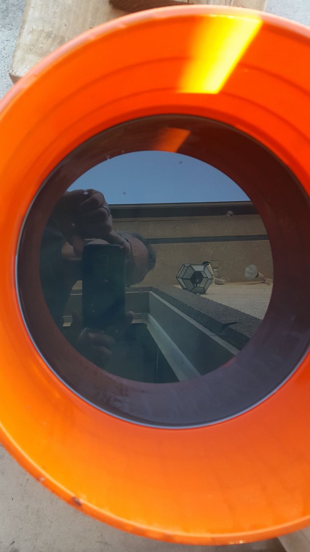

Tahoe540 07-03-2018 03:42 PM
Here is the milkshake and the one I just drained. The milkshake had about 5-10 more minutes of runtime https://cimg8.ibsrv.net/gimg/www.off...129858e344.jpg
https://cimg9.ibsrv.net/gimg/www.off...b25df0c329.jpg
