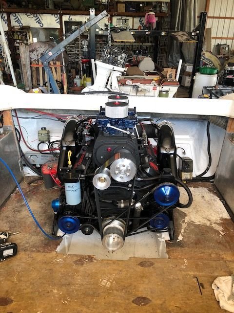

I have 1 1/4" from the water pump to the crossover then -12 AN from the crossover to the bottom of the headers and -12 AN from the top of the headers to the ends of the tailpipes for dumps...you can pretty much see it all in this pic....
I was more concerned with oil temp than water....shouldn't it come up to temp or only while I'm running hard??

-12 is kinda small for feeding exhaust imo. What happens here, is you simply reduce water flow thru the system by restricting the exit side. If you look at what mercury uses, usually youll find 1" or 1.125" hoses feeding the exhaust.
I use crossovers as well, but with 1" hoses feeding the headers. A couple weekends ago i went boating on a small local lake, where the water was 90+ degrees. I maybe saw just over 100* water temp running hard. Thats why i asked what size lines you have, because if youre seeing those temps with no thermostats, you probably are lacking water flow.
been down that road with a buddy. He had procharged engines. He was feeding the imco manifolds with -10 lines. His exhaust manifolds would be freakin hot after a run, and his water psi was very high. I suggested he switch to -16an, but he went with -12 instead. It helped a bit, dropped some psi and manifolds werent as hot, but still to small imo. Eddie young uses minimum -16an if not larger if i recall on his stuff.
as far as oil temp, i recommend an oil thermostat setup. Keep the water cold, and the oil in the 170-220 range, get the afrs in line, and you should be golden.

Thanks!! I do have the stock oil thermostat setup that came on the engine from merc(525 sc) and still with that the oil temp gauge never came off of 140...Maybe just didn't run it long or hard enough or like I said the sending unit is in the wrong spot
Before I start changing a bunch of stuff and getting crazy I think I'm gonna get the heads back and get it back together, rejet it, and try it again...If the temps become an issue I'll look into upsizing the water lines...I did check my headers while I was running and they never got too hot to lay your hand on so at least the lines aren't way too small haha
