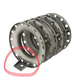

There are 2 types stock and competition what did you guys buy ?
I use the 'competetion' style. The inner diameter is slightly bigger. 5 ring unit. I measured a 6 dB sound decrease and no rpm (power) loss at WOT compared to straight wet exhasut. Other slip in silencers reduced the sound the same amount but choked the motor 300-500 rpm at WOT. This was with a stroker small block and 4" thu hull exhaust.

What you think ? I think it helps slowing waves from entering aggressively in the tips
Again I run the Competition version 5 ring 4.5" X 5.5" I also have rubber flappers on 525SC's that are about 2" above the water line. I have no reversion issue and they made it much quieter with no power loss. I have dry exhaust that meets water about 1/4" from the end.

What holds them in place?
