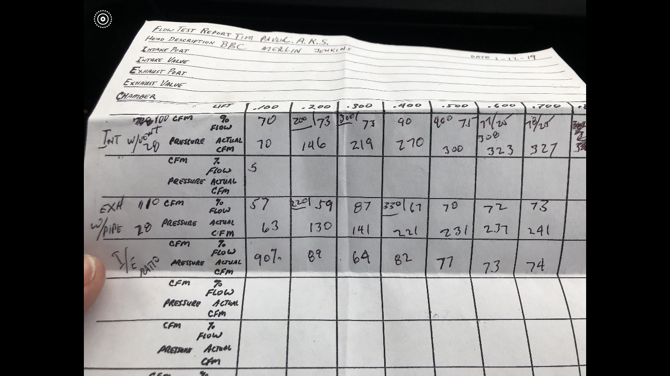

Well refreshing heads and my head guy says there is a cheap and easy 30 cfm to be had, so I am going to clean these up for now, not fully working them but since I need to do valve job why not pick up a few HP as merlins leave a lot to be desired... 30 CFM or more has to gain something...
60hp if you’ve got the lift and duration to take advantage of it....

duration yes, lift questionable, cams are .600

Well got some numbers today, we are gonna clean them up some but not go nuts, I am not gonna spend the money to fully work them right now, if ever, but there is decent gains to be made while we have things apart

Originally Posted by MILD THUNDER
They have a 26* valve angle. Most aftermarket performance heads have a 24* valve angle.
Heres some flow numbers from my head guy. All flowed on same bench, same fixture, etc
Ported 345's almost the same as stock Merlin 320's?
mine are box stock those are the numbers as of now.
Will be a good before and after comparison.
I was looking at the comparison that MT posted. Not especially interested in the #'s, more interested in the comparison using the same test equipment. Looks like the Darts were knocked in the dicl< after porting.
