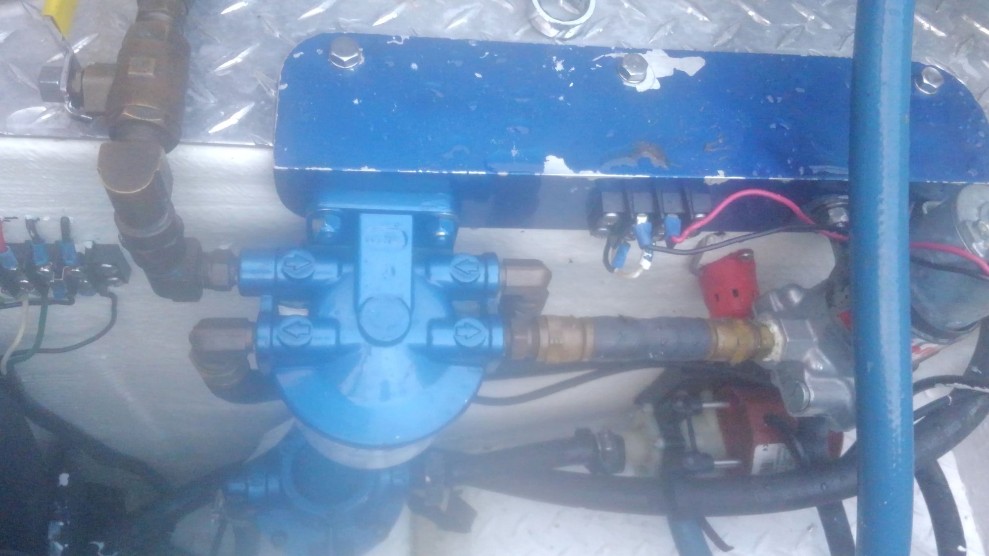

In the second pic, you can see the Tee fitting. The electric pump outputs to one side of the Tee, the center of the Tee is screwed into the INlet of the mechanical pump, and the other side of the Tee runs up to the carburetor. The outlet of the mechanical pump runs back towards the forward bulkhead, back to the fuel filter head, presumably as a return?

That's a very odd setup to me, you might have 6-7 PSI at WOT but more than likely you don't have adequate fuel flow due to the Mech/Electric pump setup. It appears to me that the mechanical pump is robbing fuel flow from the carb and sending it back to the filter head.

That plumbing doesn't seem correct, what would the mechanical pump be used for?
