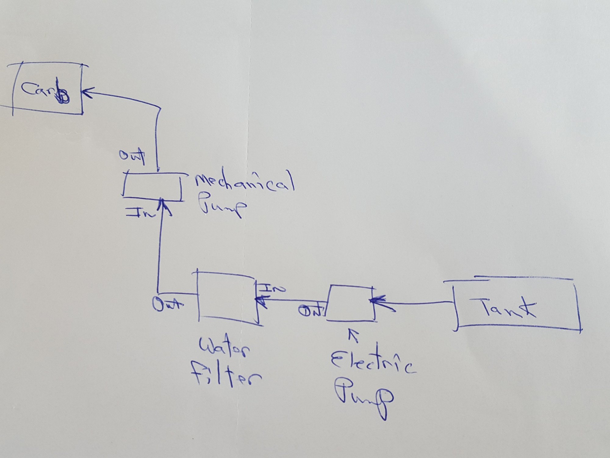

Originally Posted by Jim Diesel
Correct, the SSM and TRS boats had a booster electric fuel pump that ran when the engine would crank and as long as the oil pressure was over 20 PSI. The Electric pump sent fuel to the fuel filter/separator, then to the Mechanical fuel pump, and from there to the carb.
pretty sure this is what Jims saying in the crude drawing I did........... but you have the output of the mech pump returning to the water filter fitting ?? then the second output from the water filter going to the carb ?? you're loosing pressure especially with all the 90* fitting in the lines..

My system has the electric pump drawing fuel from the tank, then sucking it through the filter, then into the electric pump, then under pressure, to the mechanical pump.

My Holley red pump wouldn’t even keep up with my stock 454 with mostly straight fittings. How well it would work in conjunction with mech pumps is above my pay grade. Those look like 3/8” fittings which seems marginal for a 540.
7-8# of pressure is good but that just means the flow into the carb can be a restriction at the needle seat, or however these carbs are built. You can have full pressure on the line and still suck a float bowl dry.
As near as I can tell someone stuck big power in this boat, probably got frustrated with not getting them to run well (didn’t upsize the supply side), and sold it?
are you saying there is two electric pumps and a mechanical pump
No. Each side has a tank, then a filter, then the holley red electric pump, then a mechanical pump, then a carb.

From: Midwest & T-Rock
why is the output from the mech pump being returned to the filter head instead of going to the carb, the way its hooked up its doing nothing

I don't know. If the output of the mech pump was connected to the carb, then the Tee that is on the input side of the mech pump, would receive the output of the elec pump on one side, and then return to the tank on the other side. Would that make any more sense?
