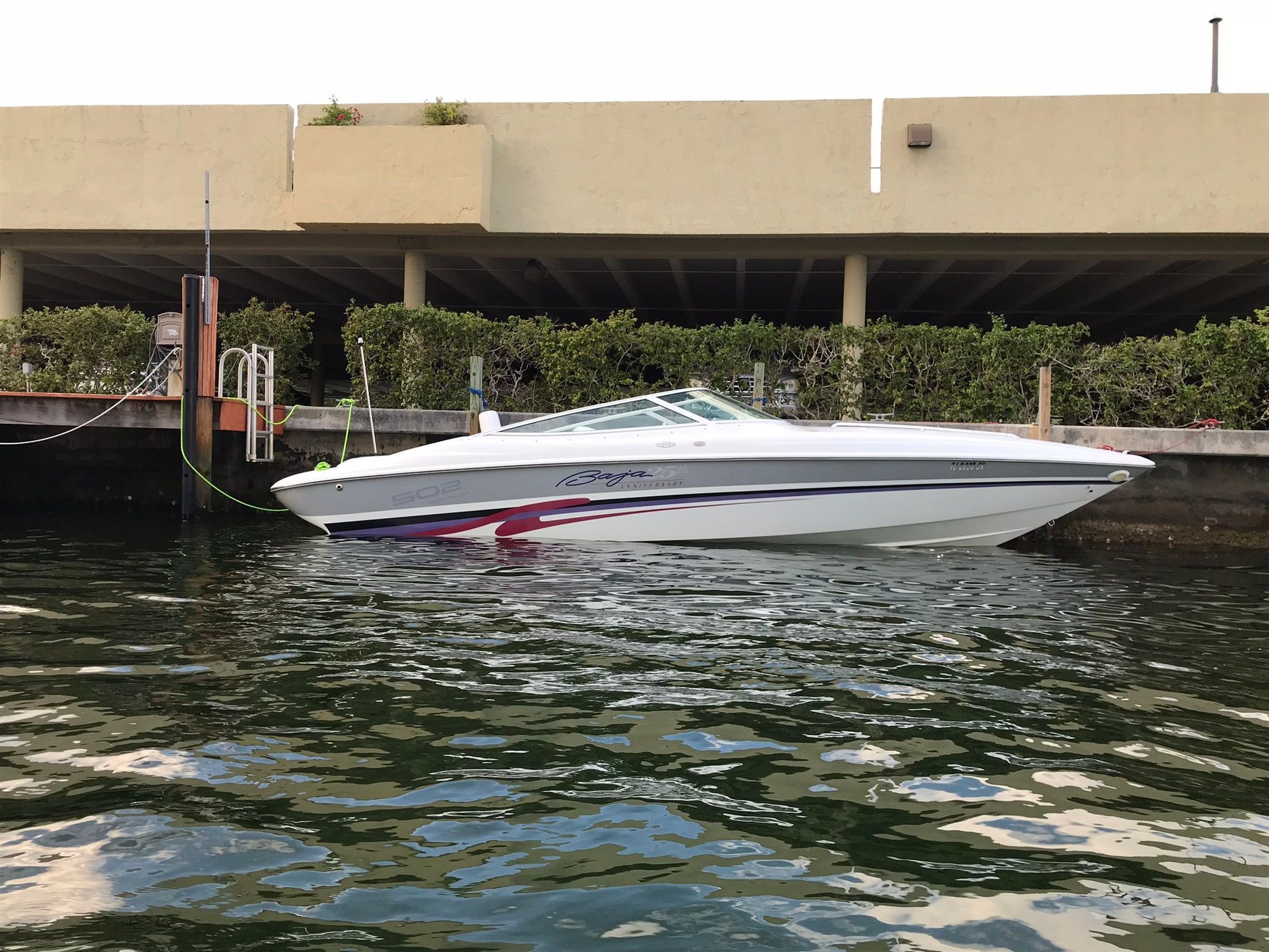

boat is in florida,, salt water! And yes i flush the engine each time i use the boat,
i really try to take the best care of her, i enjoy too much ride the boat,
she is a sweet old lady!
