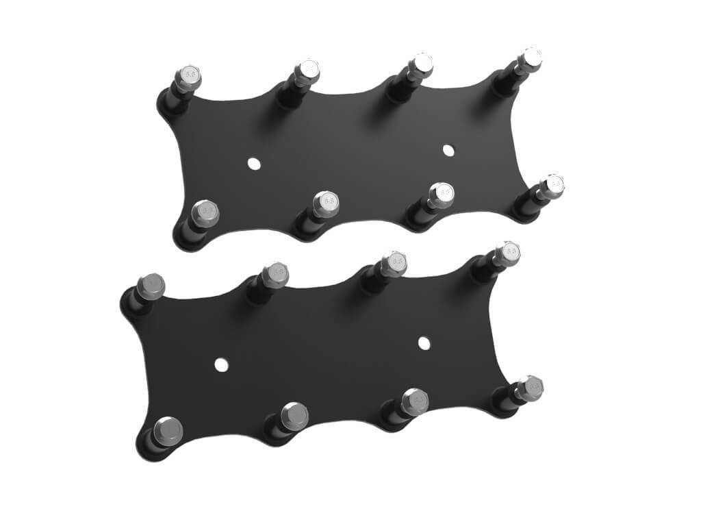

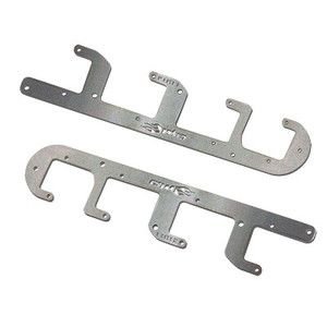

holley makes these and I have somewhat copied the design with carbon fiber sheets or composite sheets. Then drilled my own holes, then used spacers and isolators to mount the coils and installed in the best possible location per apps. I also have used these holley coil mounts in the pic as well. If I get a chance to go thru some of my past SD cards to pull up pics, Ill see what I can post. Hopefully I do not have to go thru too many SD cards to find these pics. I have so many and all full with boat related stuff.

used these before
