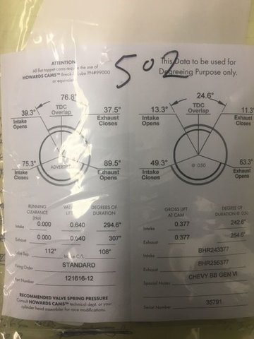

Here’s the full spec sheet.
here's the full spec sheet..,.,.

Thats a lot of cam for a 502. Probably needs to spin close to 6000rpms for peak hp.

very close to my cams. You’re right. Mine made power to almost 6k through wet exhaust. It won’t make 600 with those exhaust though. Gonna need a good ignition system to tame the idle also.
OP carb or fi?

It’s also got more lift than mine.

dyno sheet shows it hit 600hp at about 5200-5500. 610 ft lbs @ 4900. off a carb. pump gas. Crude Intentions ... do you have reversion issues at all? or did you? do you think I will with this exhaust.

With dyno headers? That elbow radius looks brutal and those manifolds aren’t as good as headers.

think were getting off track..... my questions had nothing to do with the horse power of the motor.... my question was about reversion not whether or not anybody thinks the motor has 600 hp or what I will need to change or add to keep it that way....
looking for info on reversion with what cam it has.....
thanks.

When it’s claimed 600hp people will point out that it won’t be that in Marine trim. I went with hp500 risers which go up quite high and back down. I haven’t noticed any reversion yet but yes the cam is capable of it.
