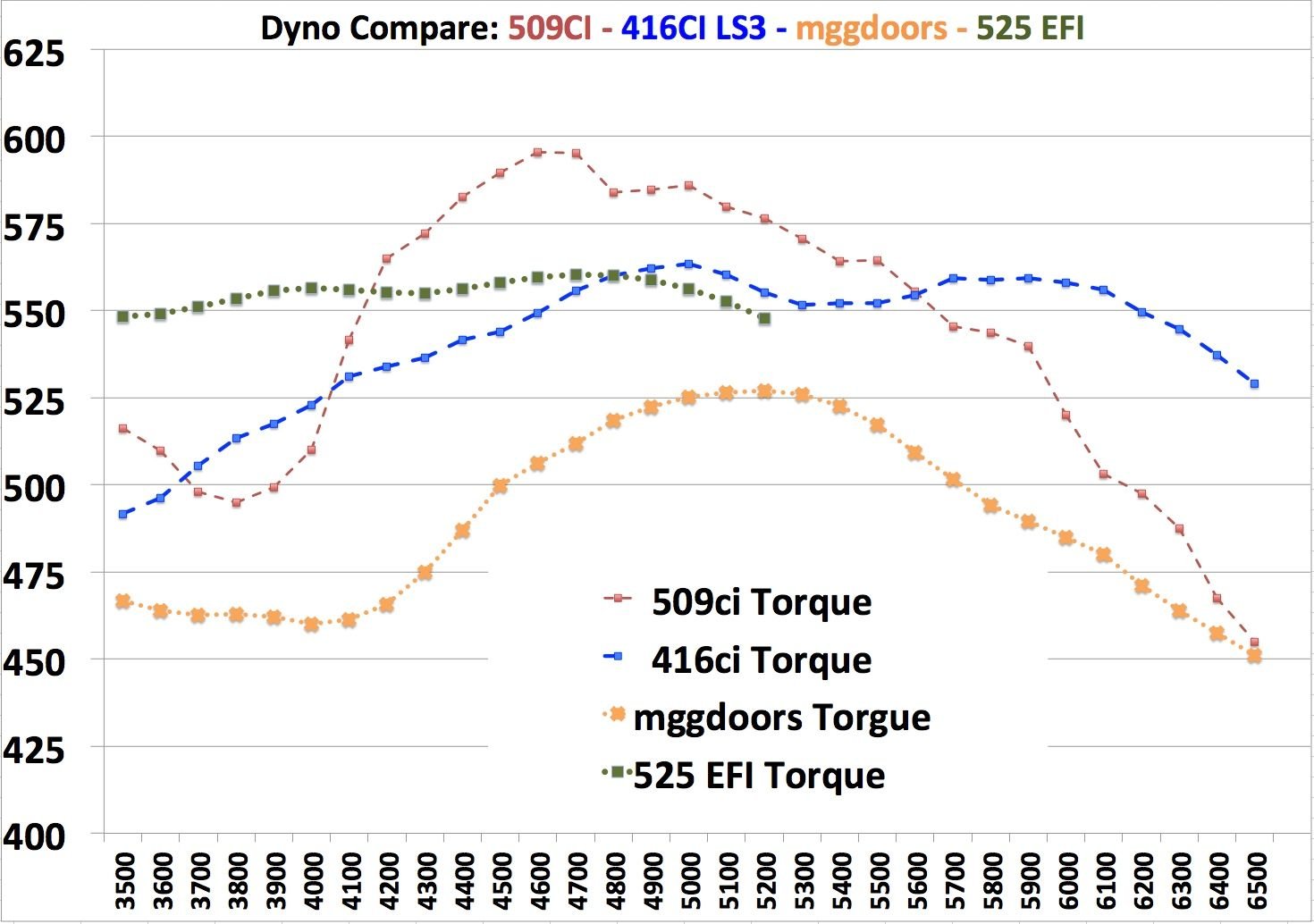

Originally Posted by bck (Post 4685388)
What magic is this? I'd like to do this.
Looks like excel maybe. Should have done a hp one too. Even better would be a comparison of common engines such as 496ho, hp500, 525efi, and 525sc. That would be cool to see

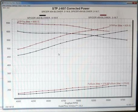

Originally Posted by phragle (Post 4685387)
https://cimg6.ibsrv.net/gimg/www.off...de7f1b6768.jpg
Here is a 454..basic 525 sc clone, 8.5:1, AK alum heads, 731 cam... Without doing a lot of number crunching, it was a pretty budget friendly build
And this is why I questioned dyno accuracy when comparing my run to the 525sc that was run. The 525sc sheet I posted was well below those numbers with the same cam. But to be fair I have no clue to what heads where on it
phragle 05-06-2019 06:11 AM
I stated what heads...AK Racing....
Wildman_grafix 05-06-2019 10:10 AM
Originally Posted by 242LS (Post 4685385)
Here's a torque comparison of the 4 dyno sheets in this thread.....
https://cimg7.ibsrv.net/gimg/www.off...9c4e62ac2.jpeg
You can tell what mercury was aiming for, talk about a solid flat TQ curve.
mggdoors 05-06-2019 10:13 AM
Im talking about the 525sc dyno sheet i posted. I have no clue what heads were on those engines as they were a customers of my dyno shops

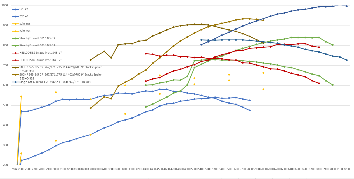

hogie roll 05-06-2019 11:02 AM
Heres some NA pump gas big blocks, boats and street rods.
https://cimg4.ibsrv.net/gimg/www.off...2e31cb04d6.png
14 apache 05-06-2019 11:13 AM
That looks like connect the dots lol.
