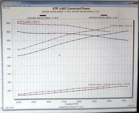

I put the 731 in mine, haven't ran it in the boat but it ran like an ape on the dyno..... This was playing with different pullys
731 is a bad *****. Is that with chiller? 625 or so? Pic is blurry on phone.

no chiller but alum heads,,731, 6 psi boost, we spun it harder and made 640 on one pull. the black is 4 pounds,,,
