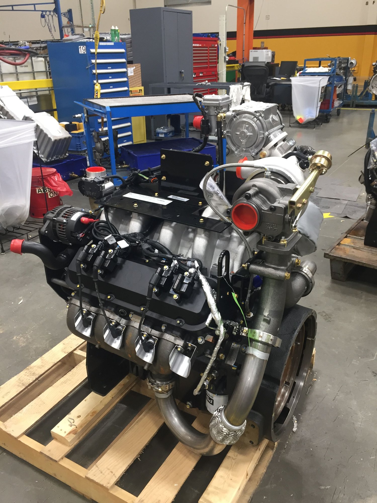

psi=power solutions inc.they make&sell generators worldwide.the block is made by dart.the engine was designed to be a low rpm high torque engine to power a fairly large genset,it runs on natural gas or lp depending on what the owner wants to use for fuel.it is an alternative to diesel fueled power units.
