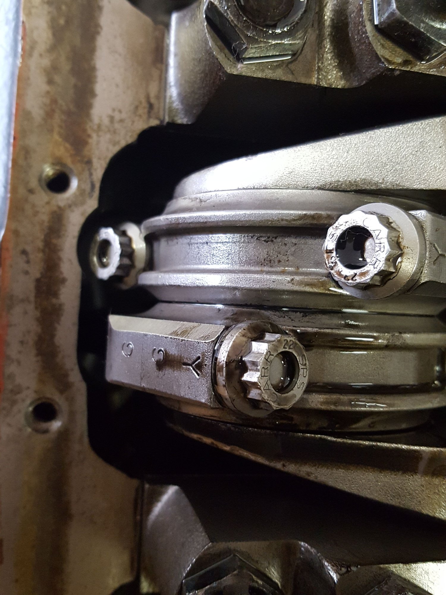

Working on a pair of these originally 572's now 580's for a friend, pulled the pan and looks to be flat tappet cam and lifters, can this be retro fitted to a full roller ?? check out the notching in the block for the long throw crank.
thanks for any input,

yes it can.all the mark4 blocks can be converted to roller cam.

Edit: I just noticed the CARR on the rod bolt, must be Carrilo rods ?

i did notice that.i have those in my 588s and they are not cheep,looks like nice engines.
