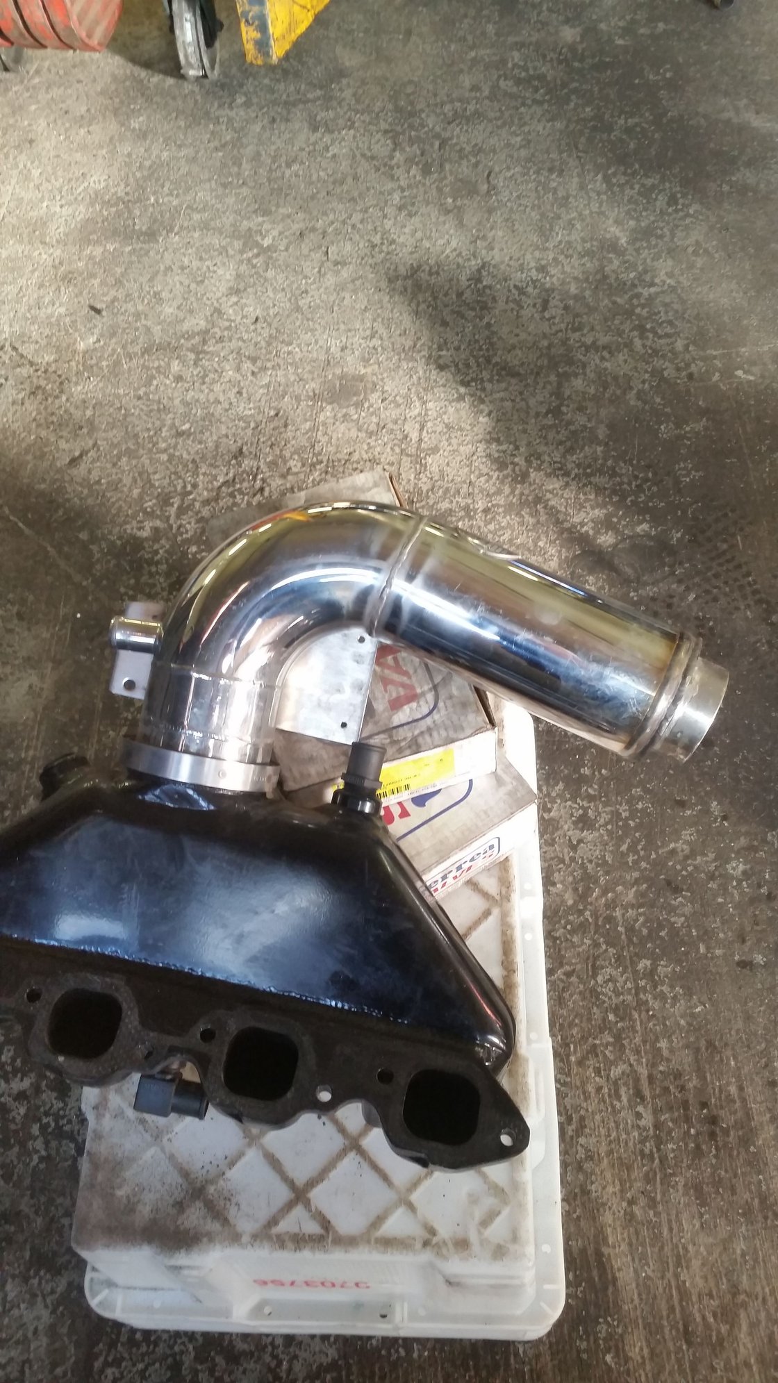

What is your build. If your searching cams I wouldn't get anothing under 112-114 lsa. I would think try and keep overlap btwn 8-14. Those risers will revert relatively easily. Especially if you idle a lot. I've been pretty fortunate over the years with the exception of my first marine build with a 109 lsa and stock cast manifolds. I never idled much with the exception of docking. Over 1,500 rpm out the channel however my first experience with reversion. It would still suck in some water periodically and get milky oil.
Does the water dump just past the 90 at the weld or closer to the end of the tip.
It dumps the water to the tip, going to extend the inner pipe almost to the transom. My build is 502 with ported peanut heads. Currently looking for flat tappet cams with tight 108lobe and 224 @.050. Duration, overlap 9° @.050 and 59° advertised. Lifters are rhoads original wich will cut the overlap to 48° advertised @ idle
