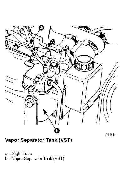

The low pressure mechanical pump fills a "bowl" the high pressure pump sits in. The high pressure pump then sends the fuel from the bowl to the rails/injectors.
Electric pumps like to push, mechanical pumps like to pull.
The price for the high pressure pumps is in the 600-700 dollar range...there is a cheaper alternative and the one Speedy mentioned is it.. There is also a micron filter on the bottom of the high pressure pump that can get plugged up. Also be very carefull with the oring on the vst pump, that sucker is not cheap either.

You need to get a basic understanding and look at system diagrams on line. the low pressure pump (depending on gen) is mounted on the sea water pump of conventional bbc location. The vst tank is on the top back of motor. and if your mechanic hasnt installed or recieved the pump yet, you can still save yourself 600... (or your mechanic ordered the hundred dollar pump and told you it was the 700 dollar pump)
