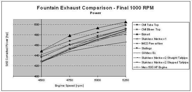

Mark did a similar dyno test on a 509 and the results were clear for the eickerts. I dont remember the exact details but it was some where around 30+ over manifolds.
Were the Eickerts close to the dyno headers?

In the "famous" published test Eickerts outperformed Imcos by about the same amount as Ive seen on my dyno between imcos and EMIS last fall. I'm going to say with your 710 hp 540 you'll still lose 20 or 30 hp at least. Muffled dyno pulls vs open header dyno pulls, gives cute numbers that are exciting but if a guys got carbs and they spend alot of time tuning with open headers then bolt manifolds on its going to end up rich. Wish I would have had a set of Eickerts to try, Im going to bolt a set of junky 1 7/8 headers I bought and made fit dyno and see what happens with them on this, I'd really like to find a set of headers that give results as close as possible to manifolds for dynoing and tuning, Smitty
I wish I had a set laying around, I'd send them you for testing. Right now, I'm running the factory 525 headers; however, they do not have equal length runners. The Eickerts do have equal length runners (or very close to it), as well as longer runners. Either way, great test with the EMI's.

That's an old test done on an HP 500, I have all the charts to this test. It would be great to see the results on a higher performance engine, one like being tested here. Bill, why don't you send Smitty a set to test out so we can see the real improvement over a typical manifold?
