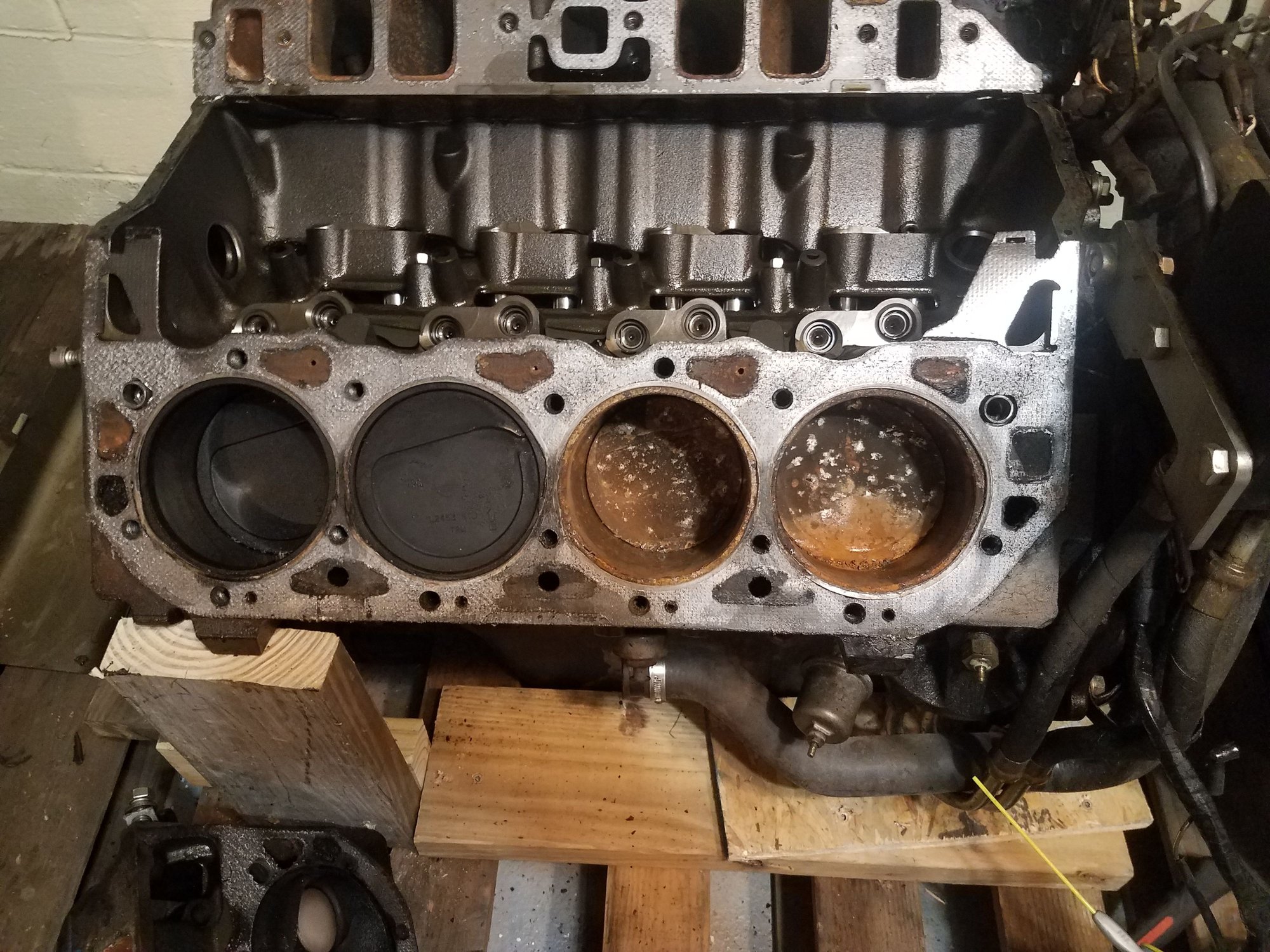

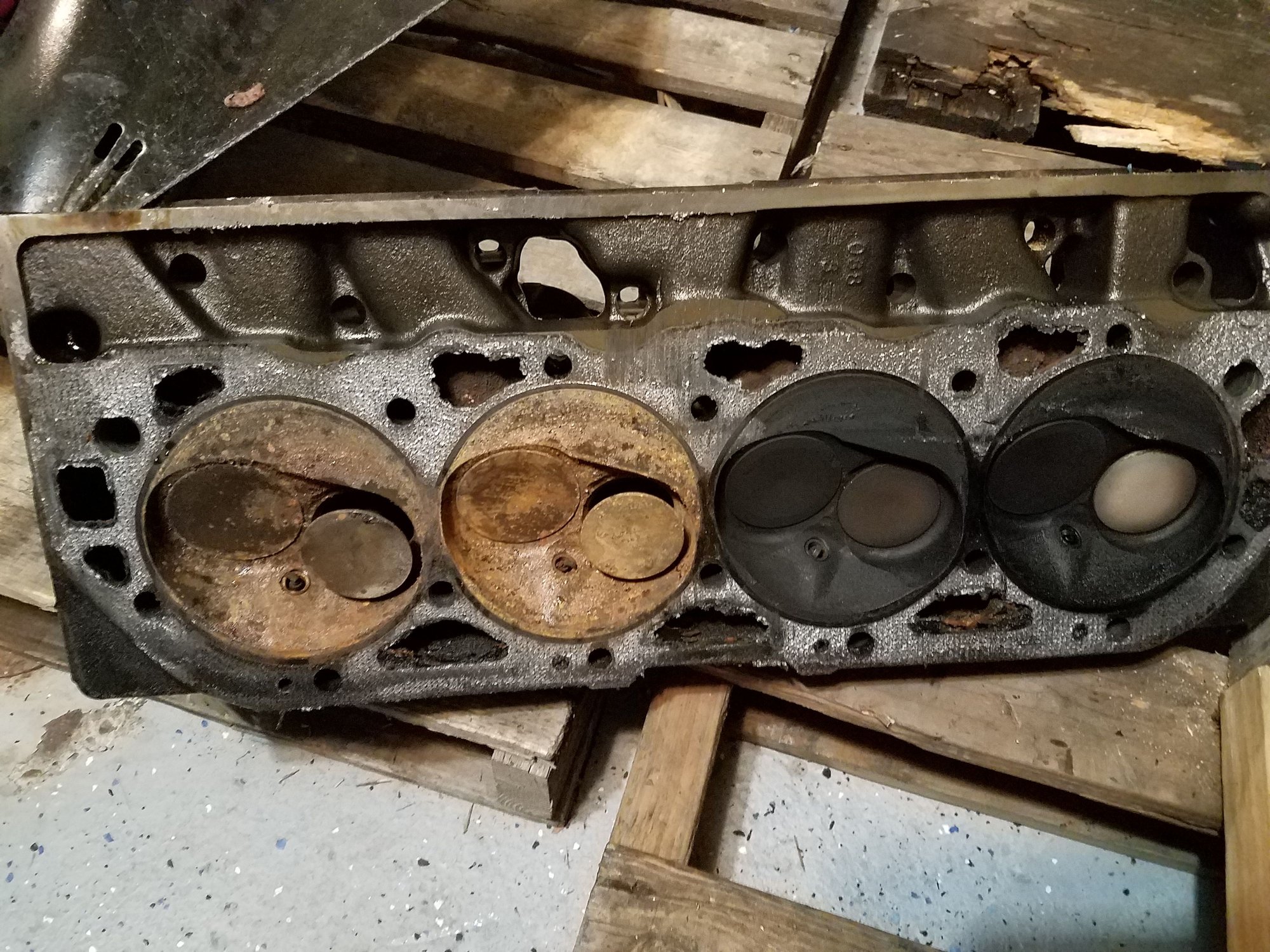

At least you got your problem tracked down... I need to find out how I got water into the number 5,7 and 6 cylinders on my 525sc motor... All the gaskets appeared ok. Next step will be checking head and block for cracks...

And your exhaust, why are those valves stuck open ? or were the springs pulled

exhaust leaking appears to me...have engine down for same issue, looks way better than that but killed a piston
Do you still have the Gil exhaust?? If so, that would be my guess. I had to replace my Gils on my 525SC at 250 hrs. Hairline cracks in the dividers just below the risers.
