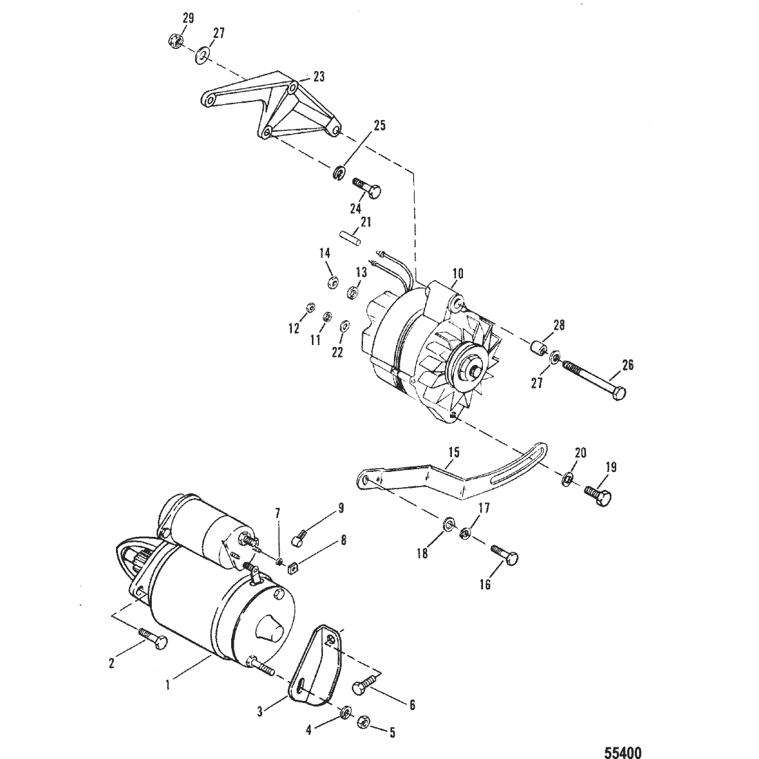

This is what will happen without the brackets (#3)..ie:.grind, grind, grind.
https://www.mercruiserparts.com/bam/...y/31808/961/10

Originally Posted by TomZ
I just looked through a parts diagram... I do not see anything about a support bracket.
What year + model/hp engine or VIN ?

Sorry. I missed the 420hp TRS part. Your starters don't bolt to the engine blocks, therefore my info is invalid. someday I'll read better. Doh !
