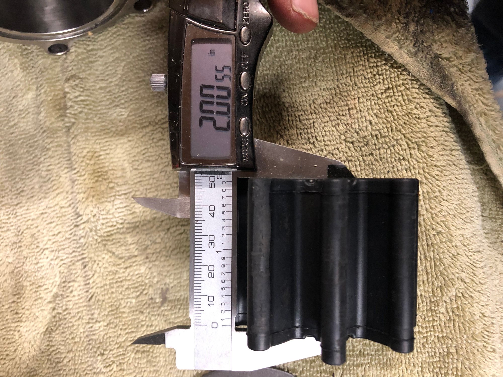

Do you have a caliper to measure the depth of the stainless housing?? Might be to long.
The depth reads on average 2.08 and if I give the impeller a firm reading it’s pretty much 2.00.

It looks like nearly an 1/8” gap. This is the oem Merc impeller. I got a Sierra one laying around and brand new measures even smaller.

You have this wear plate in the back of the pump correct?
Nope. That may explain a lot.
Good job on the find.

The Hardin email mentioned it, “inner wear plate”. I do have the same pump and thought as I was putting it together how the pump probably wouldn’t work at all if that small piece was missed.
True. In the haste of wrapping up a full rebuild trying to get it wet for the weekend it was missed. I vaguely remember it looking like a scrap blank of some sheet metal punch. OSO braintrust FTW!
