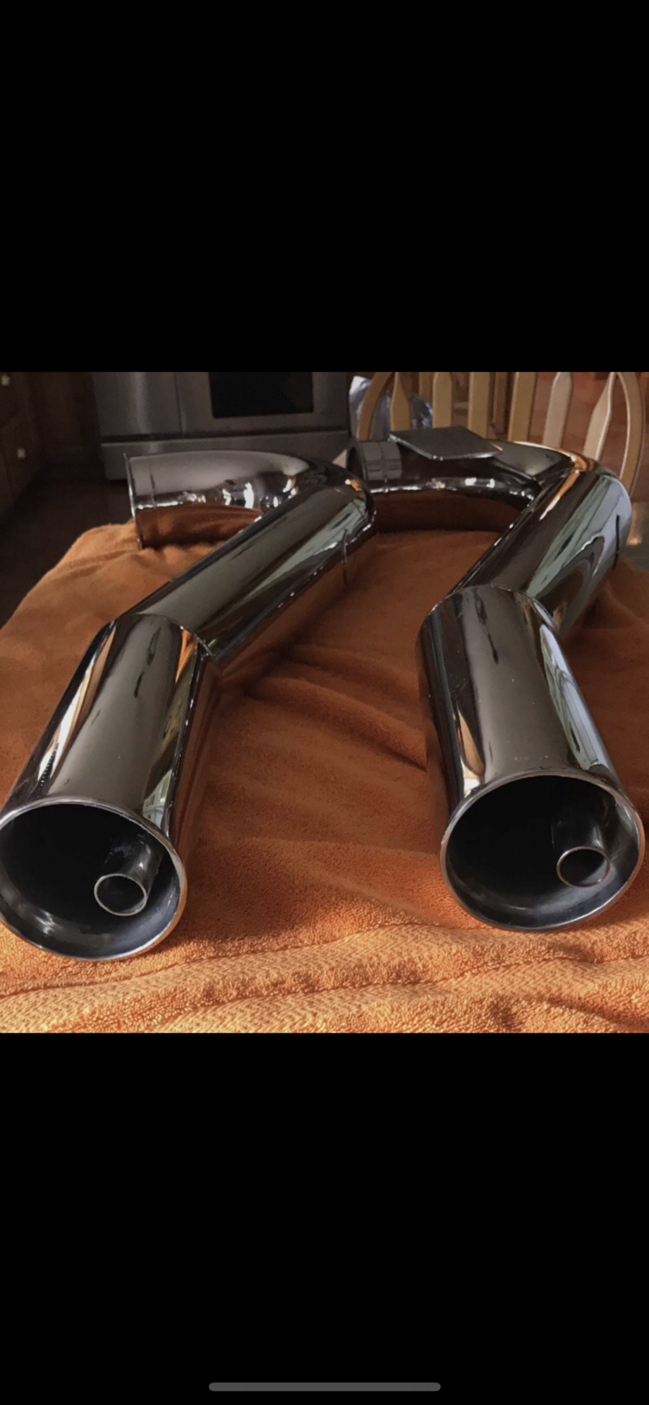

injectors,,maybe retorque the intake manifold also,pull the exhaust pipe and see if its wet,may be reversion.
dont tell me reversion. Just bought brand new dry pipes 2 seasons ago. Also why would it be skipping on one and not the other with reversion? Only other thing I can think of is injectors.
stick some rubber hose on the water dumps,,extend them and see if it cleans up the skip.

i hope your wrong!!! lol. I’m gonna pull plugs and possibly a tail and inspect with boroscope. if no evidence of reversion I’m good. We do have some tubes used for winterizing it might be worth a shot.

No way you are getting reversion with those risers on a 500efi. Not saying it couldn't be getting a little water from a bad manifold or intake gasket though.

Pulled one side of plugs...no sign of water or rust. Plugs do look a little lean. Going to replace them all. I would think this rules out reversion. If it were reversion there would be serious signs of water. We do run in salt water.
