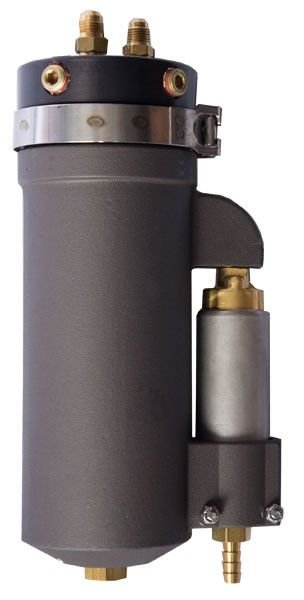

Cell...the link below shows a update kit from Nautique from an extinct older version - pump and filter are in one unit mounted top right (vertical on the front of the engine - short runs to injectors and return) and the lift pump
https://www.nautiqueparts.com/product/retro-fcc-kit/

the newer version is this they have been using the FCC for over 20 years for efi engines. and that is correct PCM in not tank mounted - its external. The FCC still needs to be serviced.

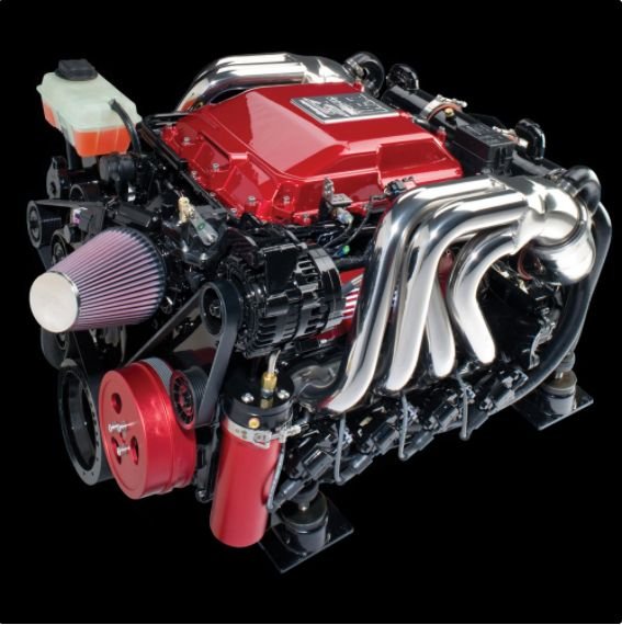

I called my former tech and he too, has never encountered an issue with VL in the Nautique system... as BUP said, it's 20+ years old, still in use and easy to service - even the FCC filter is a viable filter system vs. what collects in a cool fuel... this FCC system supports the big motors - XR7 and XS7 (550SC/hp) towboat
Pic from PCM website - red vertical canister that is under Alternator
