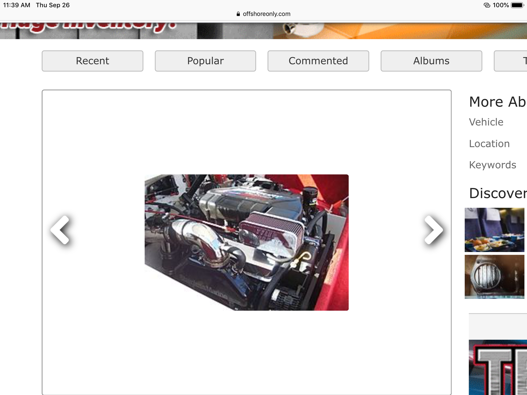

Here’s a pic of the Tyler Crockett 454 Mag EFI upgrade. Upped the HP to 461, the sound upgrade was worth every penny.
Looks like a expensive upgrade. My boat isnt worth what you have in this motor. Guess I stick with stock. Man if it sounds as good as it looks im jealous.
