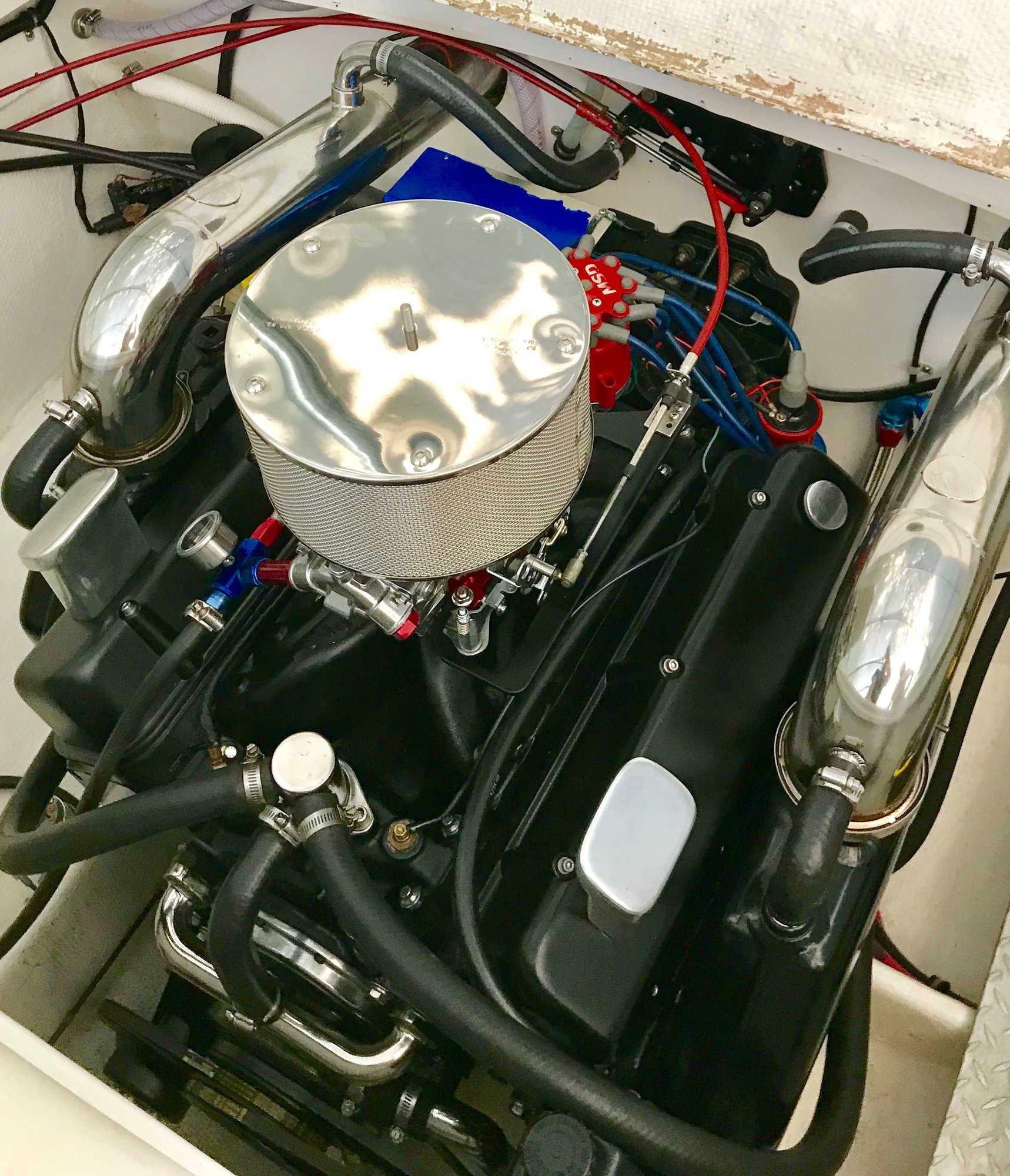

I am having the same problem. Dart block, Harden Marine crossover, 160 t stat. Cold water goes in one side of the crossover and hot water on the other side and out of the bypass. Not sure why.

What you described is what I've been speculating to be the case. Just to confirm, you're saying that hot water from the block is exiting from one of the inlet ports and back into the crossover, then out the bypass. Correct?
How did you verify that?
I was thinking of replacing the rad hoses that connect to and from the crossover and to the bypass with transparent/clear rad hose. That would enable me to see the directional flow of water. If there's more volume entering one side of the block than the other, that could be creating a circulation effect, and as the hot water leaves the block it gets pushed out the bypass.

You have an IR Gun, check each leg of the cross over to see if you are experiencing unbalanced flow. I have the same setup and it works perfect, although I added a -10 line from the back of the intake to the front intake cross over to bleed off any steam and to insure good water flow to the heads. I have checked my temps with a good IR gun and my temps are within 1-2 degrees everywhere. What is the water temp you are running in? I was out last weekend in 55* water and idling down the river, I barely got to 115*. Once I got to the lake and pushed it hard it warmed right up. Water temp was 155* and oil temp was 250*. Yes I know my oil cooler is a little small.
