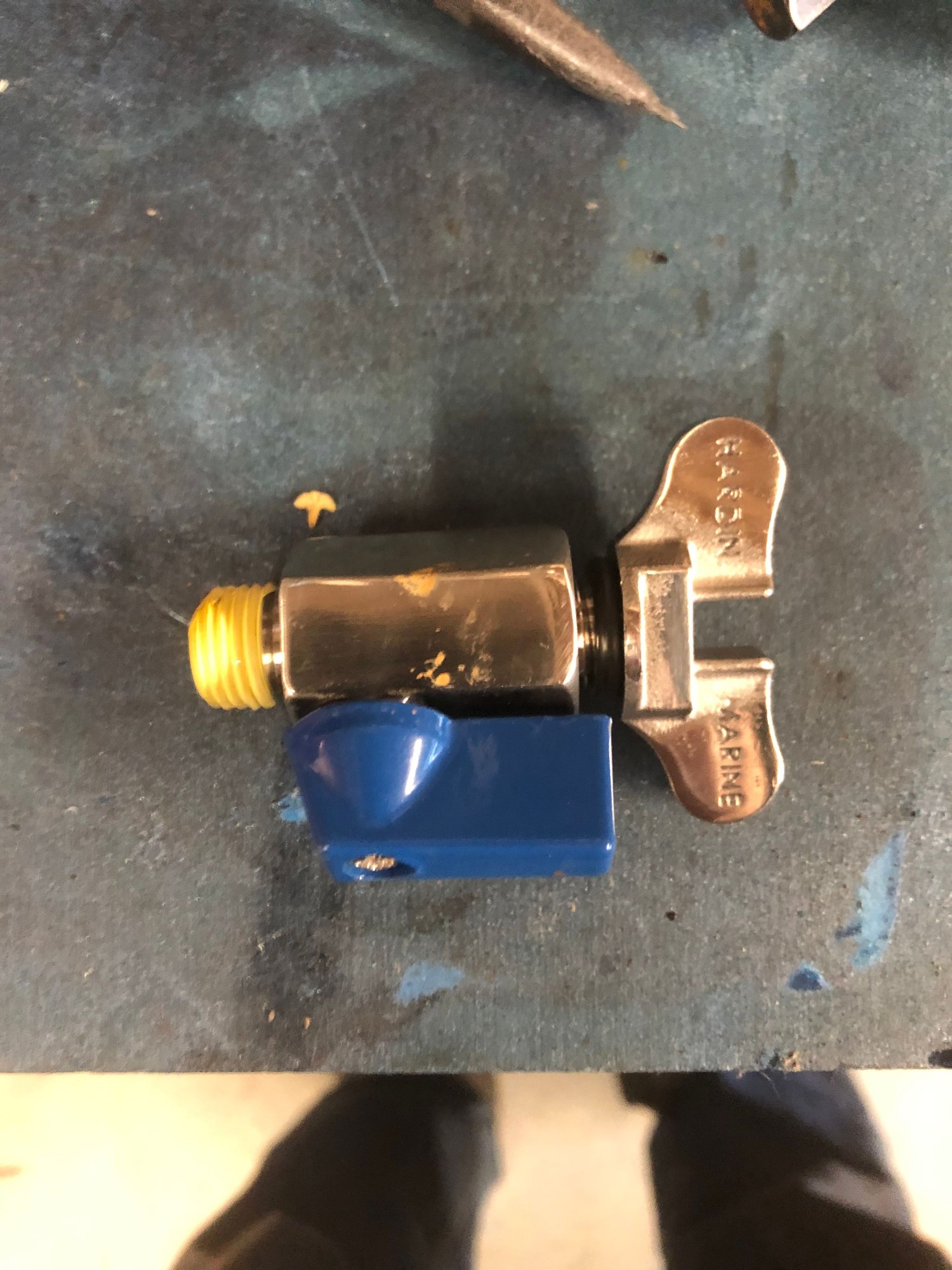

I put ball valves on my block with some wing plugs just for good measure. Waaaay easier than fumbling with any wrench in there.

i think GETRDUNN posted this how to do,,,i added 3/8 pipe to AN 6 fitting, then 16-18 inches of number 6 stainless, then AN 6 fitting and cap plug.
works great ,as before my closed water system was added , it was really hard to reach fitting on side of block, and now with closed coolant system , i can t reach anything on STBD motor,,so works great as fitting / plug lay in front on motors.
DRAIN THE MOTORS...
