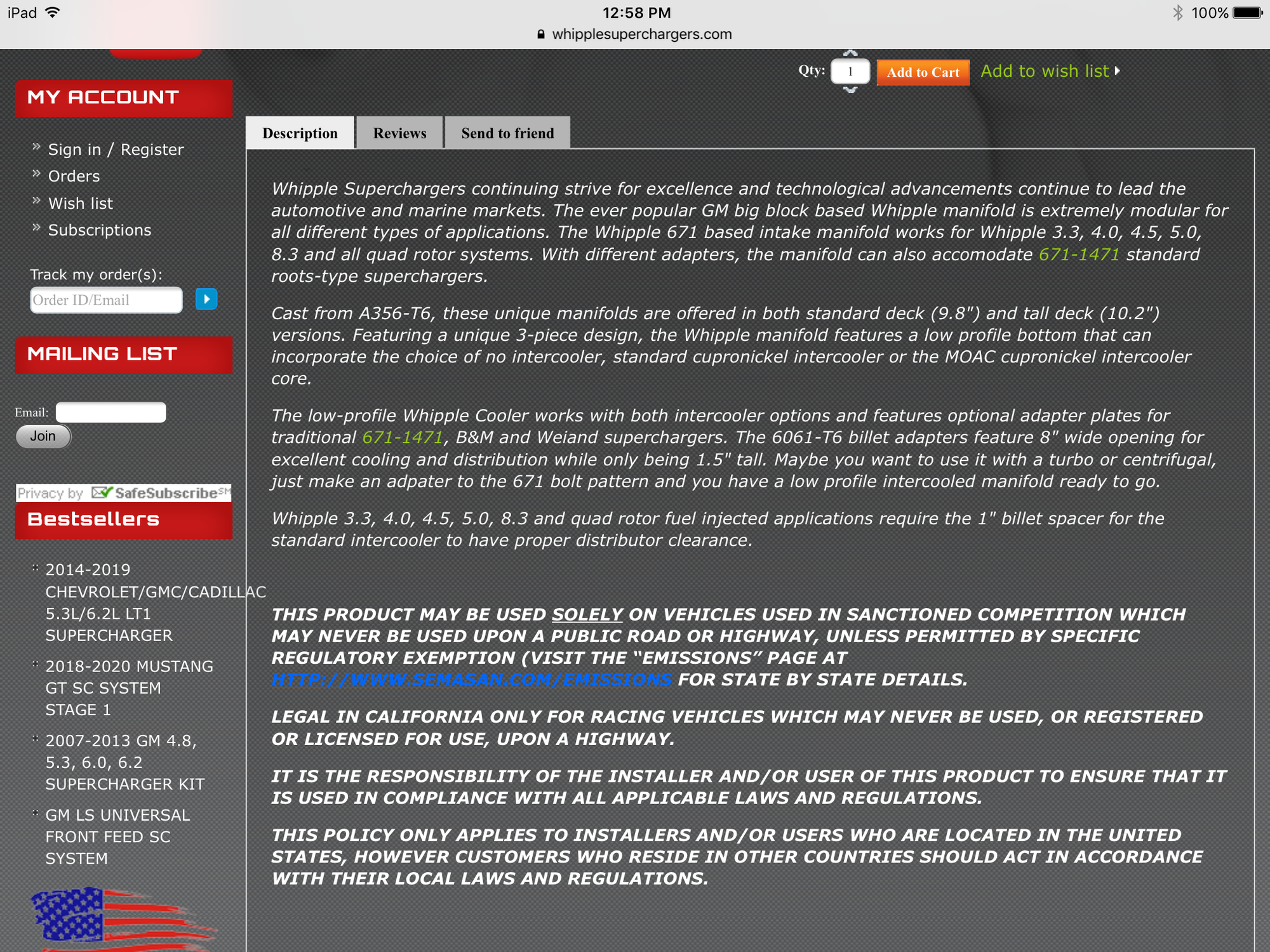

Check out their website. You can definately use whipples intake and be able to accommodate 6-71 through 14-71. May require some adapter plates. Going the other way from your traditional roots intake to that of whipple not certain. Whipples intake is completely open plenum. Here's a pic and some info.

Yea I saw that so worst case I could buy that...thing is I have a blower shop intercooler now and would like to retain that although I may not even need an intercooler with the whipples...no way in hell I'm paying whipples prices for their intercooler...not happening lol
Might just have to fab my own adapter...I think the base of the 8-71 might actually be wider than the mounting plate of the whipples but not sure on that.
